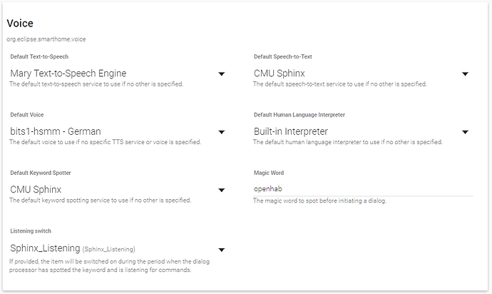

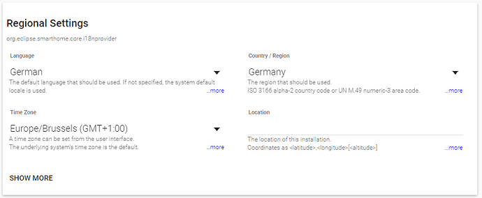

conf/servicesand adjust if necessary - Run openHAB and finish the configuration in Paper UI:
- Configuration > System:

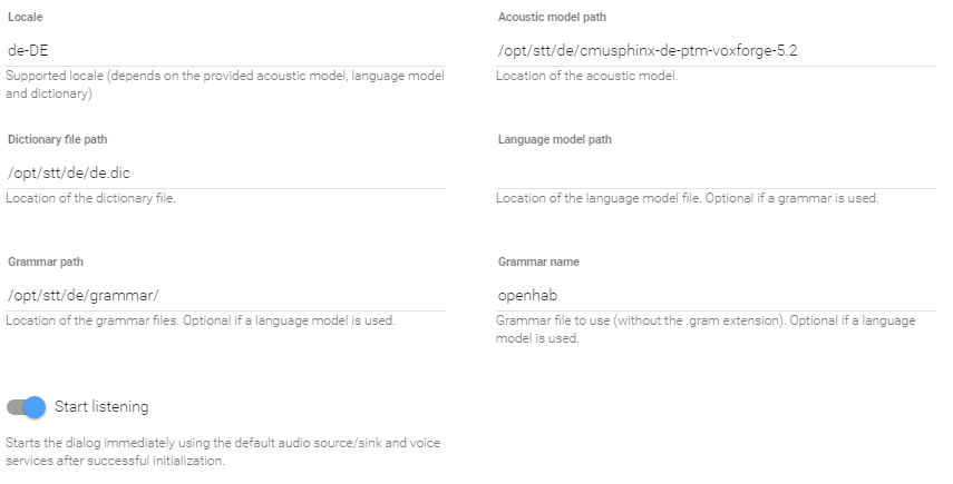

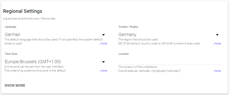

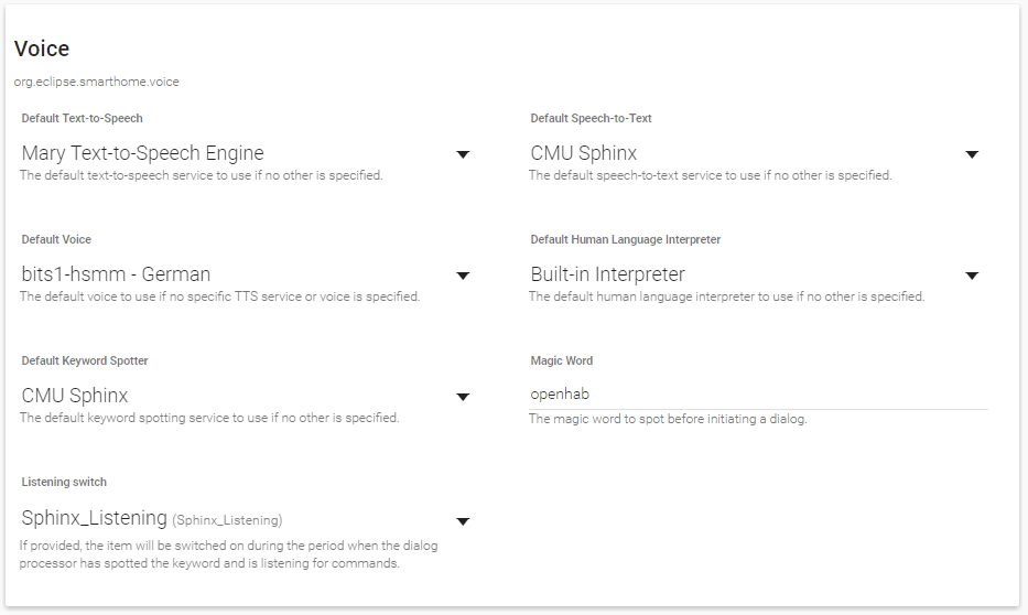

- Configuration > Services > Voice > CMU Sphinx Speech-to-Text:
Note! Only click Save with “Start listening” activated when you’re ready and Snips is stopped (the Sphinx bundle and Snips cannot share the microphone), because the hotword spotting/voice recognition will then start! Check the openHAB logs for any error!
