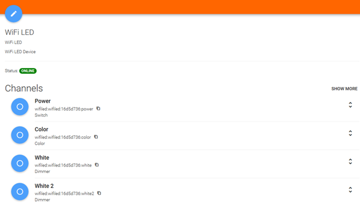

Lights arrived, got them set up on my wifi via their Lumary app, all good.
I went onto my router and found the mac address, fixed it’s IP to where I wanted it, turned it off and left it off for a while for changes to settle.
Then added the WIFI Lighting Binding, all good.
This didn’t find anything automatically so i added the item manually, which after a little fiddling of the settings on the binding, came online fine.
So, went into my .items file and added the 4 options
Switch MyWiFiLight_power    "LED Power"     <light>     {channel="wifiled:wifiled:16d5d736:power"}
Dimmer MyWiFiLight_white    "LED White"     <light>     {channel="wifiled:wifiled:16d5d736:white"}
Dimmer MyWiFiLight_white2   "LED White2"    <light>     {channel="wifiled:wifiled:16d5d736:white2"}
Color  MyWiFiLight_color    "LED Color"     <light>     {channel="wifiled:wifiled:16d5d736:color"}
Saved and restarted OH just for fun…but these items don’t link, or appear in the options to link…(issue 1)
Thought I]'d go in the other way and ask PaperUI to create the items, set them up manually and linked, which worked - don’t know why this way worked but the other didn’t (issue 2)

The frame appears on basicUI as expected but controls do absolutely nothing to the light. I’m pretty sure it isn’t working at all as the ‘power’ option is off on the sitemap while the light is on. (issue 3)

No, i got them connected to OH but they didn’t really behave in that none of the commands worked via OH but did via their app.
I need to revisit it all as I’m sure it more user error than OH…
I don’t think the Lumary controller will work with the WiFi LED Binding as seems to only be controller via their cloud service. I think i will be swapping the controller for something like this.. https://www.aliexpress.com/item/4000166845240.html?spm=a2g0o.cart.0.0.6e843c007BDDJX&mp=1
i think this should work with generic binding and can be flashed if needed I believe.
