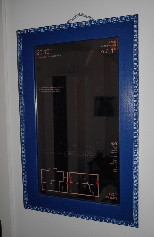

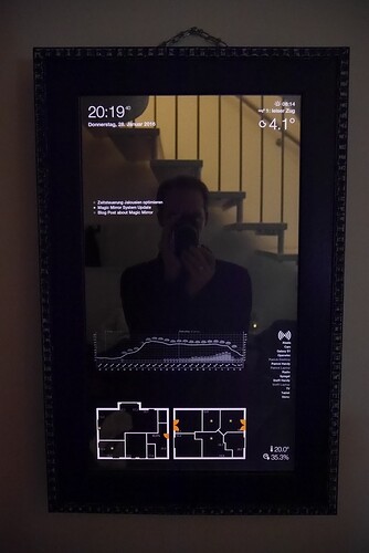

I’ve actually built such magic mirror myself. I also included stuff from my openHAB instance running on a separate raspberry. I’m just using the REST interface of openHAB to get my current states (reloading them in various intervals).
Unfortunately I haven’t had the time to commit stuff to my github project and the code is currently a little messy. ![]()
If you wan’t I can provide some JS/PHP snippets here because I don’t think I will/can commit it soon.
Here you get some impression how it currently looks (currently I’m displaying lights, windows, sockets …):

My version also periodically accesses the Rest API to retrieve lights, window and door contacts, temperatures, and Wi-Fi state of several devices.
The floor plan is simple, each light and window contact has its own transparent overlay image.

wow amazing - how is the mirror build? I mean is it just a Display in the back or how?
Yes, it is a 24" screen with a spy mirror of the same size. Here is how I built it: paphko: magic mirror
