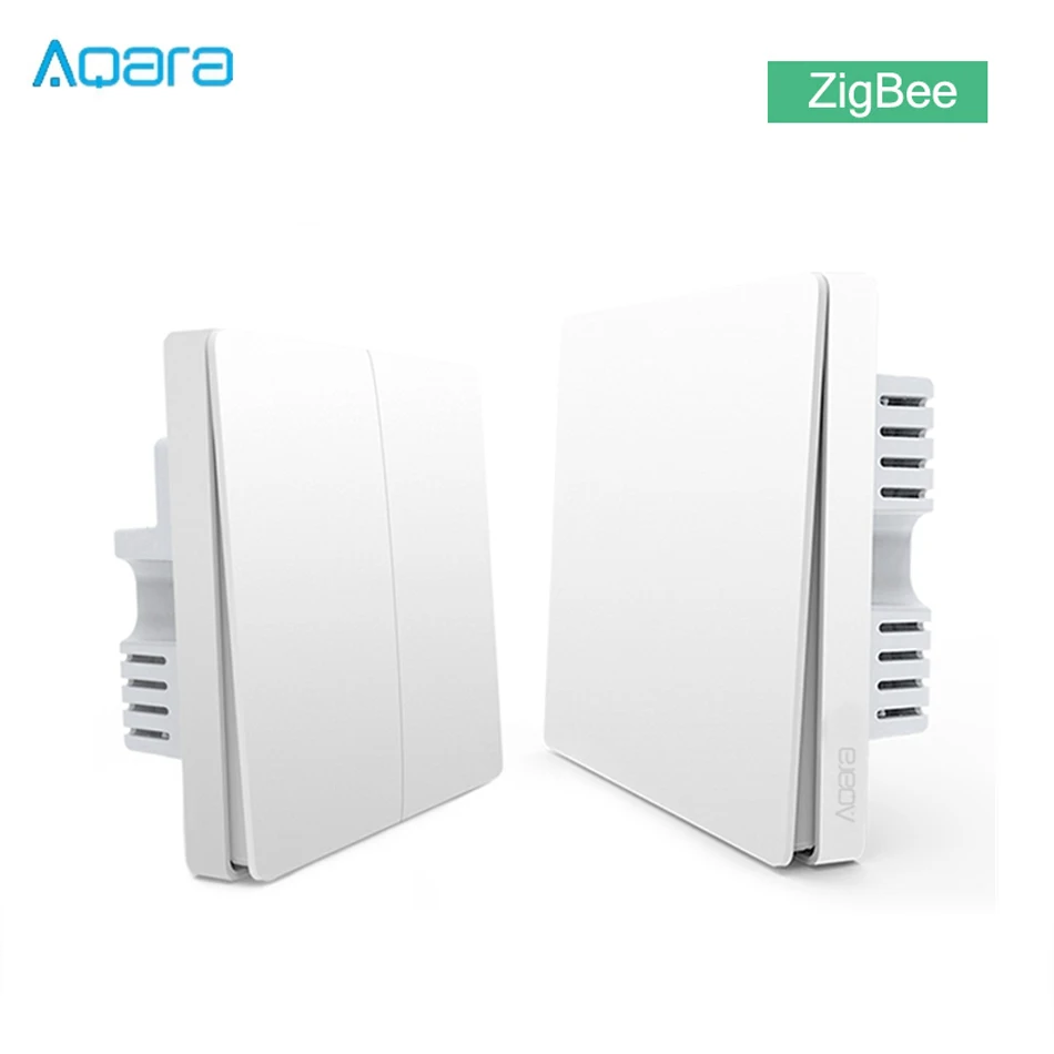

I found smart actuators which can be controlled like bulb, to be used together with normal bulbs. Devices like the hue dimming switch/remote, which would not replace the regular switch, but instead add another switch to the wall. And also the Aquara zigbee switches to be installed into the wall, which sadly don’t fit into regular German mount boxes.
I guess the Aquara switches would fulfil my requirements, if they would fit into the switch mount box, but they don’t.
