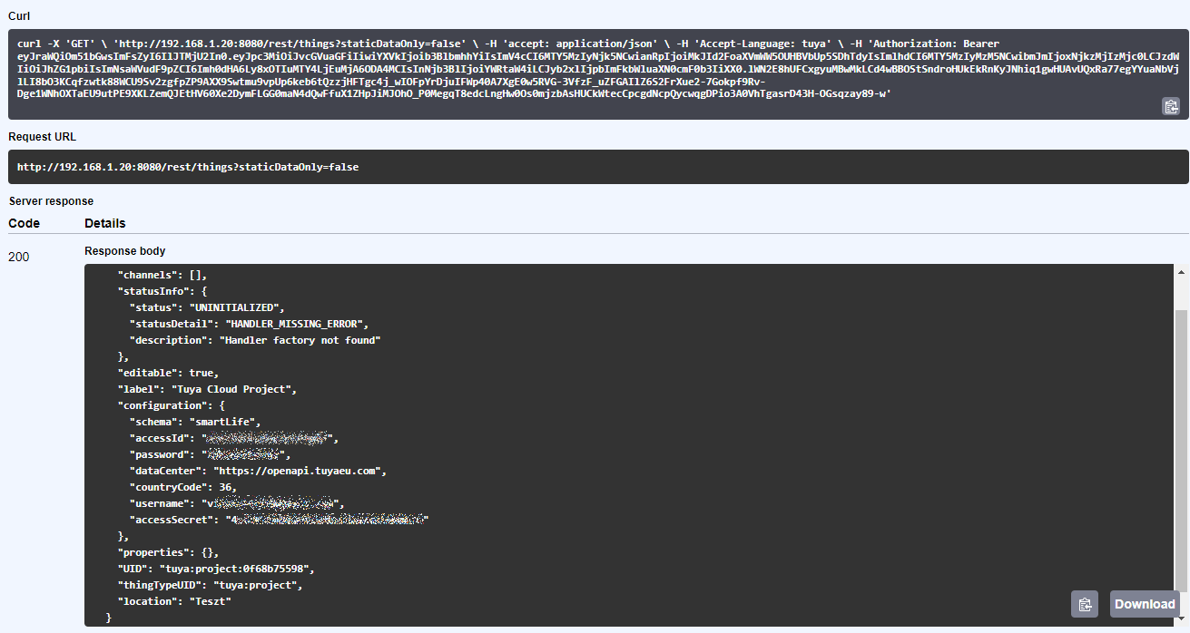

I installed the Smarthome/J snapshot binding (https://download.smarthomej.org/addons-snapshot.json) on 4.0.2. When creating the Tuya Cloud Project I get the following error:
What am I messing up?
I tried on versions 3.4.5 and 3.4.0 with the line https://download.smarthomej.org/addons.json.
I found in openhab.log: Cannot create thing. No binding found that supports creating a thing of type ‘tuya:project’.
