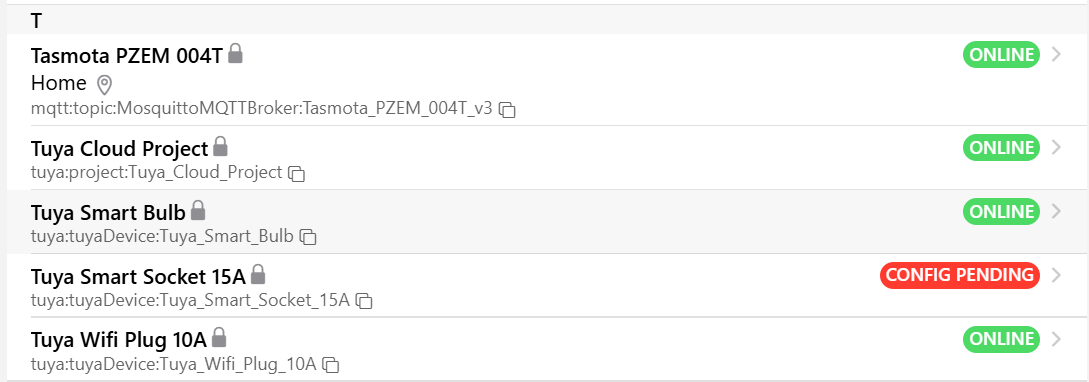

I need assistance with the Tuya Smart Bulb. It goes online, but I’m unsure how to set up channels, and I can’t locate any documentation on it.

Hi all,
Just browsed through the topics in search for the solution to my problem. The situation is as follows. I have one wallplug and one light bulb from Tuya and they where just working fine and Openhab was in control. The I decided to buy another light bulb from Tuya and I set it up using the Tuya app. After this it was discovered without any problem in Openhab, but it was always in the state config pending (unable to get ip address) but the other two devices where working just fine. The I decided to restart OpenHab and see what happens, after restart only the wallplug was working and both bulbs where in config pending state, then I restarted OpenHab another time and now one of the bulbs was working and the other two devices where not.
To me it looks like the binding is only resolving the ip address for the first device it finds and then stops at that point (wild guess). I also tried to set the ip address manually and although the devices come online I cannot control them (turn on/off). So here it comes, the question, is there someone who can help me solve this problem?
One thing I see is for the device I added the ip address manually:
[TRACE] [.internal.local.handlers.TuyaDecoder] - Did not receive enough bytes from ‘udpListener’, exiting early
Another thing:
2024-11-27 21:34:38.680 [DEBUG] [a.internal.cloud.TuyaContentListener] - Requesting ‘https://openapi.tuyaeu.com/v1.0/users/XXXXXXXXXXXXXXX/devices?from=&page_no=1&page_size=100’ (method=‘GET’, content=‘null’) failed: @2a4e58f8::DecryptedEndPoint@6d250ec5{l=/XX.XX.XX.XX:50510,r=openapi.tuyaeu.com/3.69.78.245:443,OPEN,fill=-,flush=-,to=299551/0}
Hmm ok, when I add the ip address for the bulb which was working before, then that bulb is working but the latest added bulb is not working… pending config (no ip address) and when adding ip address manually it still does not work.. and connection is terminated every few seconds. It is a ‘Calex A60 Clear E27’ bulb. I added a channel switch_led with dp 20. When the device is connected it does send this to it: Sending CONTROL, payload {devId=X, uid=X, t=1732743029, dps={20=true}, gwId=X}

Hello everyone!
Since yesterday (12.12.2024) I have the same problem that almost all devices are ‘Waiting for IP’.
My story:
12/11/2024: I have several smartHome plugs in use and have taught 2 new ones into the smartLife app and then successfully integrated them into OH as usual.
12.12.2024: I connected a new Tuya lamp (wired) and disconnected the power first. My FritzBox shut down (fritzOS 8.0 since 1.12.). After the installation I switched on the power and added the lamp in SmartLife (v.6.1.1). When adding THING via ‘scan’ it already stopped at ‘waiting for IP’.
13.12.2024:
  • This ONE lamp is still ‘Waiting for IP’. Then I updated OH from 4.2.2 to 4.2.3, reinstalled the 3rd party smarthome/J plugin and rebooted. No change.
  • In the evening I installed another Tuya lamp, this time WITHOUT switching off the FritzBox. Integration with SmartLife went smoothly again. In OH, the device was found via SCAN, but remains in ‘Waiting for IP’.
  • Another reboot of OH has multiplied my chaos! The Tuya bridge is online and 3 other devices (the 2 new ones from 11.12.2024 and an older one from 2023). But the other 12(!) no longer connect and are stuck in ‘waiting for IP’.
So what could be wrong?
  • OH 4.2.2: I haven’t changed anything to date. has made it worse for me, but not the trigger.
  • Tuya-Addon: 4.2 ran fine for months, rather not
  • FritzOS 8.0: maybe there’s a bug with the UDP settings or something else in the upgrade?
  • SmartLife App 6.1.1: if the creation of new devices in the new app works differently now - no idea. But my 2 WLAN sockets worked fine in OH. All devices can be controlled as usual in the app.
  • Tuya Cloud Project: I don’t know if they changed anything in the API when they updated the app. I think so as I received an email about AI now available. In my cloud project, ALL devices are neatly listed and I can manipulate any of them via debug.
→ The obvious choice for me: Tuya API or FrizOS
Please, does anyone have a solution? I have rules running in OH that logically no longer work (the fishes in the aquarium will be the first to notice :wink: ).
