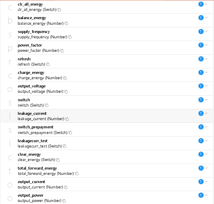

  • And this channels was also auto created:
    channels

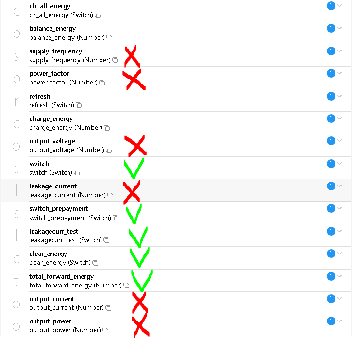

Not all channels are working:
Working: V
Not working: X
channels2
and some other functions like leakege alarm, over-curent, over/under-voltage alarm not even created in channels tab.

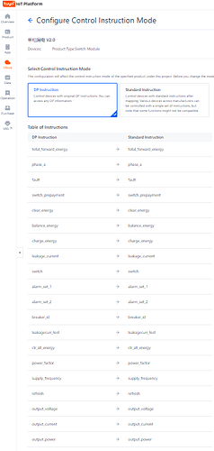

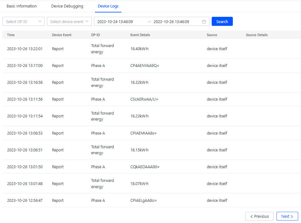

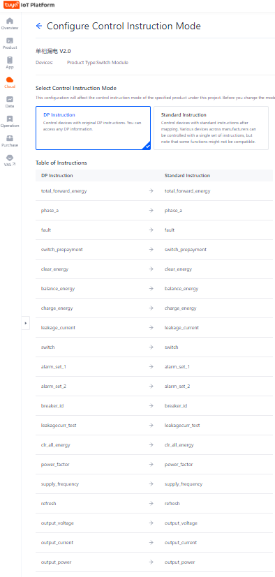

In Tuya Cloud this device configured with DP instructions:
dp_set

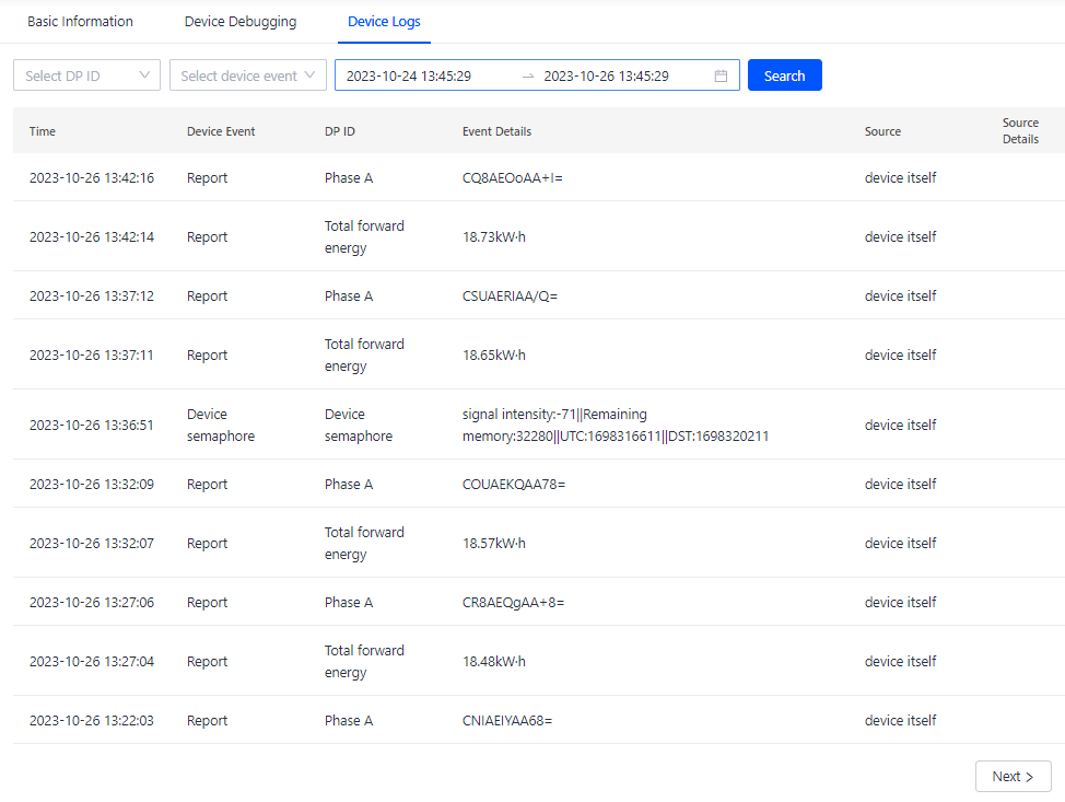

And maybe will help Tuya Cloud device log:
1
2

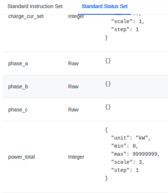

I think the problem is with this dp id “Phase A” and it wierd values.
it is too bad not to have voltage, current, power fron this device(((

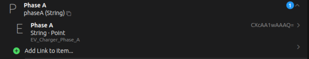

Yes - There is a ‘Phase A’ Channel for my EV Wallbox Device, which I have linked to an item ‘EV_Charger_Phase_A’
Any time that item is updated from Tuya, the script runs and then updates the Power/Current/Voltage items I also created. (Whilst Tuya also has a Phase B & C for 3 phase versions of my charger, I don’t use them - Its a single phase Wallbox, but the principal would be identical).

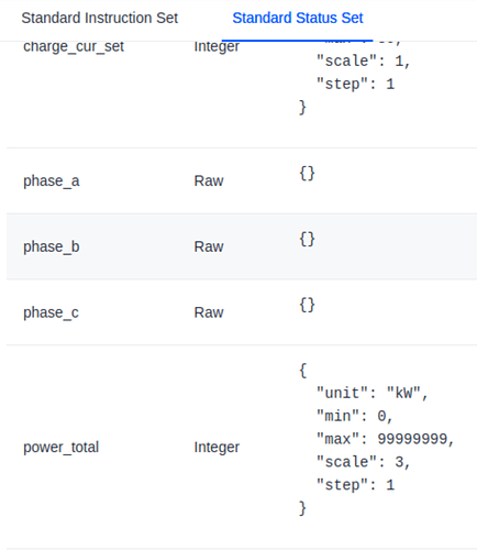

So starting with Tuya, you can see the Items in the Standard Status Set:
And then my Phase A OpenHAB Channel on the EV Wallbox ‘Thing’
I had to add/configure it manually (Add Channel → String)
I had to play around with the DP number when setting up the channel. I used the Standard Status Set Debug Page on Tuya IoT page for a clue of which DP number it was, but to be honest it was not logical
 it almost feels like the DP numbers start at 2 for my device (It was the 5th device down on the Debug page, but its ‘DP6’ for my ‘Phase A’ channel)
And just for completeness, you can see the Tuya Logs (probably similar to yours) with the values coming in there.

var power = (parseInt(payload.slice(items[event.itemName].getMetadata("power_slice_start_position").value,items[event.itemName].getMetadata("power_slice_end_position").value),16)/items[event.itemName].getMetadata("power_multiplier").value);
items[event.itemName+'_voltage'].sendCommandIfDifferent(voltage);
items[event.itemName+'_current'].sendCommandIfDifferent(current);
items[event.itemName+'_power'].sendCommandIfDifferent(power);
 console.debug(event.itemName+'Phase_A - datastr: '+dataStr);
 console.debug(event.itemName+'Phase_A - hex: '+payload);
 console.debug(event.itemName+'Voltage Slice: '+payload.slice(items[event.itemName].getMetadata("voltage_slice_start_position").value,items[event.itemName].getMetadata("voltage_slice_end_position").value));
 console.debug(event.itemName+'Current Slice: '+payload.slice(items[event.itemName].getMetadata("current_slice_start_position").value,items[event.itemName].getMetadata("current_slice_end_position").value));
 console.debug(event.itemName+'Power Slice: '+payload.slice(items[event.itemName].getMetadata("power_slice_start_position").value,items[event.itemName].getMetadata("power_slice_end_position").value));
 console.debug(event.itemName+'Voltage: '+voltage+' V');
 console.debug(event.itemName+'Current: '+current+' A');
 console.debug(event.itemName+'Power: '+power+' W');
Thanks a lot)) Your script provided earlier works without any change in it)) Even ‘Phase A’ channel works with DP6 also))
Now I can use voltage, current and power in my openhab)
