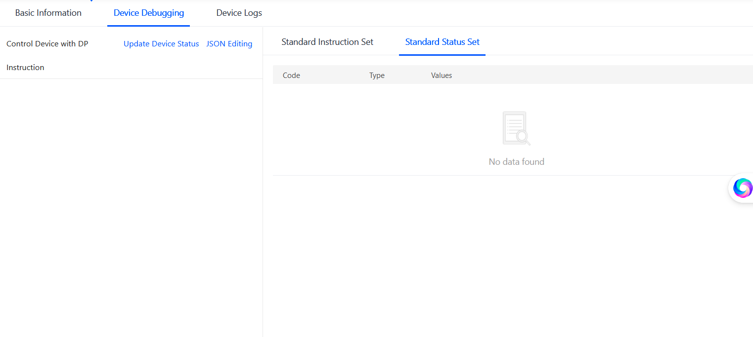

I recently bought this energy meter with two channels

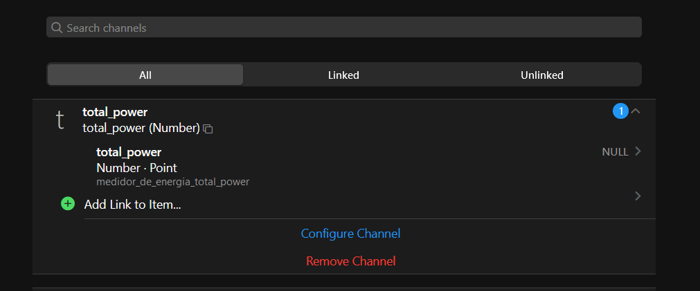

I configured Smarthome/J as explained in the topic

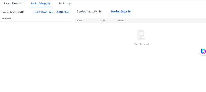

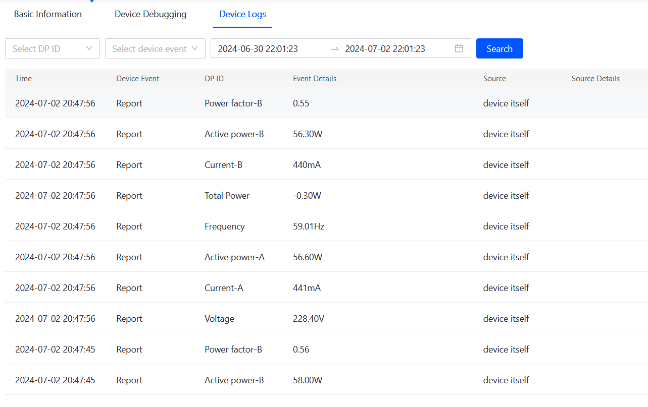

Within the Tuya cloud I can see that the sensor sends it to the cloud
but it does not have a status set
I cannot configure it in any way so that any channel that receives this data, all attempts, even using the dp id names, are unsuccessful.

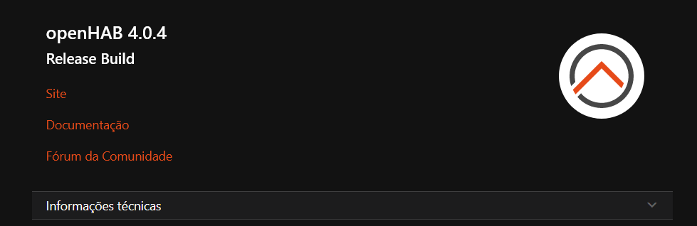

Mine version of OH4
I have the same problem with this item, but I need mapping power for A and B.
Just in case that might be useful:
