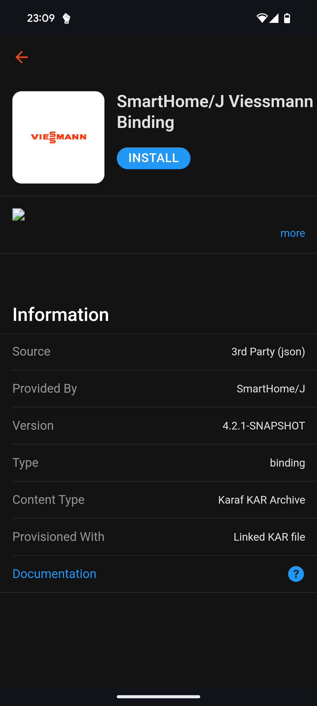

When updating, could you please also include a link to a community topic?
Many add-ons have that and I find it quite handy, since it points users to a common topic in this forum.
It would be visible on this page:
