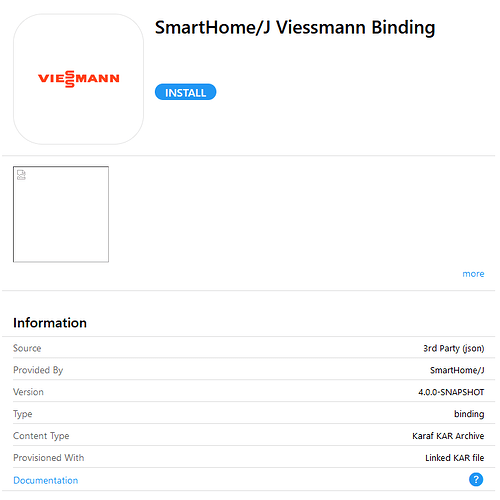

It is not installed at all, but I’m also not able to install it via addon-store. It is shown as 4.0.0-SNAPSHOT in the addon-store, might this be an issue?

Bit it is still showing me the binding with 4.0.0-SNAPSHOT in the store, what could be installed. Is there some kind of cache?
I have this in the org.openhab.jsonaddonservice.json, nothing more. What is this, can it be removed?
"json:org-smarthome-binding-viessmann": {
"class": "java.lang.String",
"value": "{\"uid\":\"json:org-smarthome-binding-viessmann\",\"id\":\"viessmann\",\"label\":\"SmartHome/J Viessmann Binding\",\"version\":\"4.0.0-SNAPSHOT\",\"maturity\":\"stable\",\"compatible\":true,\"contentType\":\"application/vnd.openhab.feature;type\\u003dkarfile\",\"link\":\"https://docs.smarthomej.org/4.0.0-SNAPSHOT/org.smarthomej.binding.viessmann.html\",\"author\":\"SmartHome/J\",\"verifiedAuthor\":false,\"installed\":false,\"type\":\"binding\",\"detailedDescription\":\"\\u003cimg src\\u003d\\\"org.smarthomej.binding.viessmann/doc/viessmann_wordmark_rgb_1_vitorange.png\\\" width\\u003d\\\"140\\\"/\\u003e \",\"configDescriptionURI\":\"\",\"keywords\":\"\",\"countries\":[],\"connection\":\"\",\"properties\":{\"kar_download_url\":\"https://docs.smarthomej.org/4.0.0-SNAPSHOT/org.smarthomej.binding.viessmann-4.0.0-SNAPSHOT.kar\"},\"loggerPackages\":[]}"
I have now completely removed org.openhab.jsonaddonservice.json, but I still see the 4.0.0-SNAPSHOT binding in the store.
@J-N-K Do you have any idea?
If you just deleted the JSON, it’ll be restored from the backup, so better replace the content with {}
(or delete all backups of that file). Make sure you do that when openHAB is shutdown. A good idea might be to also remove the content from <USERDATA>/marketplace
and use openhab-cli clean-cache
That’s the right hint. I have deleted all backups and then the 4.1.0 binding was available. Thank you for your support!
