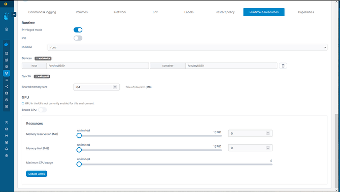

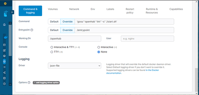

I’m using portainer to configure the container. The command is
The container is configured with privileged mode.

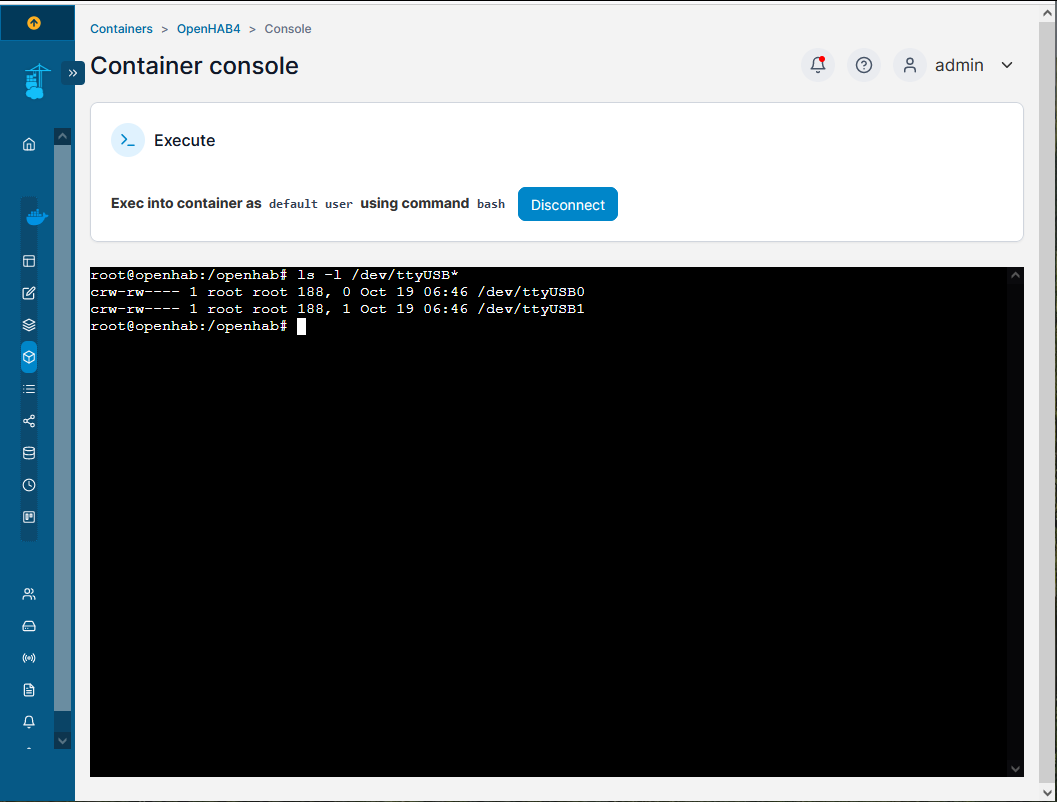

I get the same results, when I run the command inside the container:
crw-rw---- 1 root root 188, 0 Oct 19 06:46 /dev/ttyUSB0
crw-rw---- 1 root root 188, 1 Oct 19 06:46 /dev/ttyUSB1
I’m surprised that I see both USB devices inside the openhab container, as I have linked only one…
You see both devices because provileged flag. You can ommit it if you map device manually.
Core issue of problem is - openhab process within docker container have insufficient permissions to open serial port. Other container might run as root, thus have fewer constraints. Did your do some specific tweaks earlier to your NAS?
You have been right, it was an access issue. For whatever reason the access has been limited to group root. So I added a new usergroup with the openhab user and it works.
