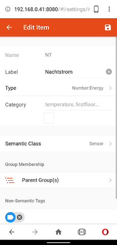

I created a thing smartmeter and got it running. Then I tried to create an item in order to link it with channel of the smartmeter.
But it slows no data, only NULL :sob:
Type is Number:Energy. Where do I put the unit? And why is no data shown? The thing smartmeter seems to work. At http://openhabiandevice:9001/?filter=1-0%3A1.8.2 are data’s. If I have to do the rest of the config of the item in a file, I’ll do that. I’m able to use nano :wink:

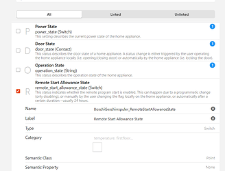

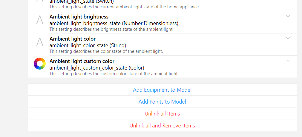

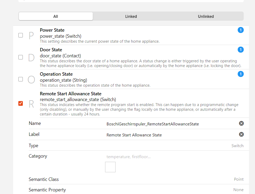

As you have already the THING running, you can use the built-in item creation function. That will make sure, all item/point types are correct and derived from the THING channel.
Go into the THING and scroll to the end. There you can generate equipment and points. Both are at the end items with special semantic tagging. But that’s not so important for now.
e.g. “Add equip. to Model” → Scroll down to channels and select one or more → “Add to model”
Don’t change any of predefined entries. Just leave it to OH. You can redo / adjust later.
