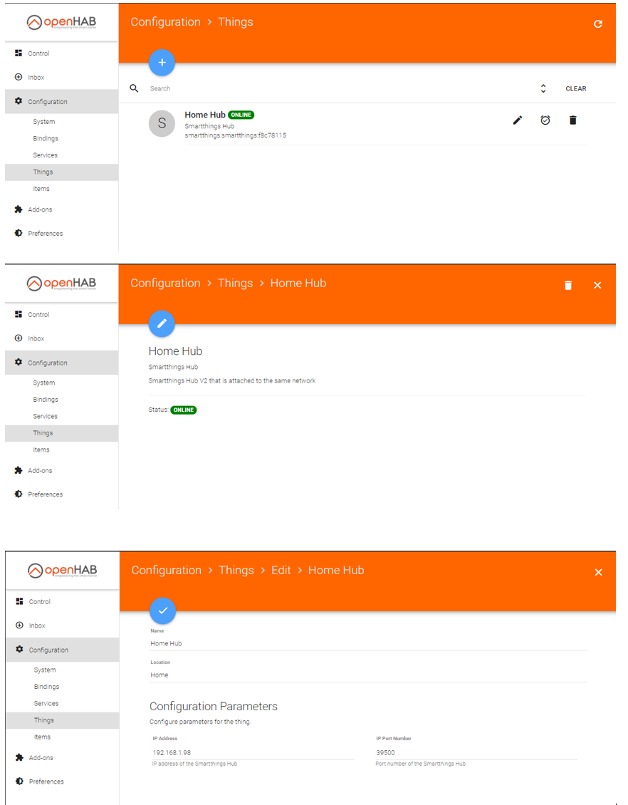

I have done all configuration on the smartthings ide side (smartapp and device handler) and installed the Addon on OH. So I added a thing, manually, from the UI, using the Smartthings Addon and manually selecting on the device the “Smartthings Hub”. I configured that Thing via Paper UI and shows for me as Online at the things tab.
However if I look for more things using the Addon it doesn’t find anything more. Another thing is that I didn’t find the .thing file to insert the “Bridge” config as the how-to says.

  • on the “things” tab on OH I included a thing “Smartthings HUB”
is this something needed? Does that already creates a “.things” file?
