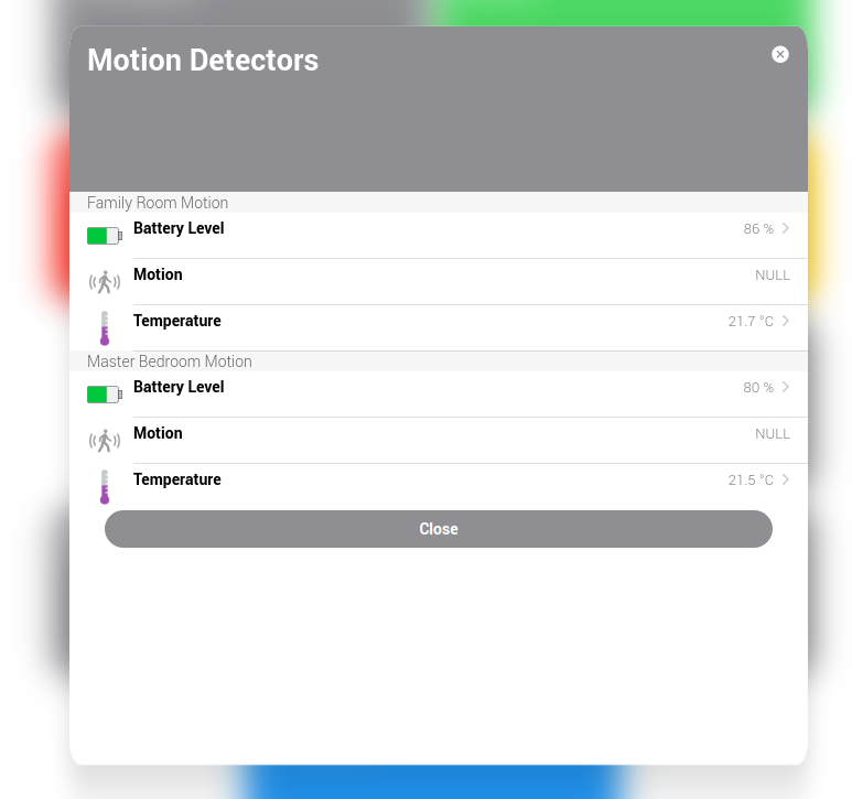

However, my motion sensors are reporting NULL for the Motion Presence channel??
Any ideas?

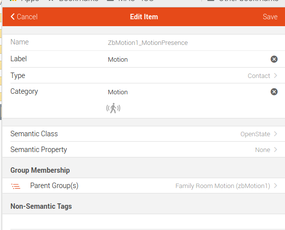

Mapped to Item with:
Type: Contact
SemanticClass: OpenState
SemanticProperty: None
Profile: (No Profile)
Should the type be switch? I thought I tried that yesterday.

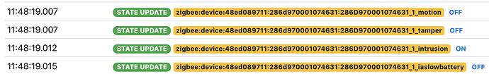

Thanks for your help and identifying the log entries to look at. I noticed the _motion was always off. Seems that the _intrusion is the one going on and off.
I got it to work by linking a SWITCH to _intrusion. a Contact type did not work kept saying null.
Seems to be working now - showing on/off rather than open/close but that is fine.
