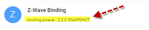

I am referring to the version number of the binding, not OH. I would like to be able and see what the version number is so I can confirm that the binding did indeed upgrade. If I look in PaperUI in Addons>BINDINGS I only see the 2.2 SNAPSHOT portion of the verion
I’d like to see the entire version number so that when I uninstall and reinstall I can see the version number change.
