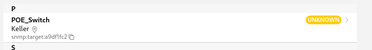

could you give me a hint please, what i have to change that it is running under 4.2.0 as before?

2024-07-21 21:20:25.241 [WARN ] [ding.snmp.internal.SnmpTargetHandler] - snmp:target:a9df1fc2 requested GET[requestID=593742948, errorStatus=Success(0), errorIndex=0, VBS[1.3.6.1.4.1.4526.11.16.1.1.1.3.1.4 = Null; 1.3.6.1.4.1.4526.11.16.1.1.1.3.1.2 = Null; 1.3.6.1.4.1.4526.11.16.1.1.1.3.1.5 = Null; 1.3.6.1.4.1.4526.11.16.1.1.1.3.1.3 = Null]] and got error: Invalid argument
2024-07-21 21:21:23.744 [INFO ] [ding.snmp.internal.SnmpTargetHandler] - Could not send PDU

also the state of the snmp device does not come any more to green:
