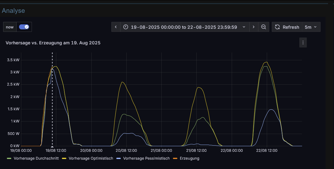

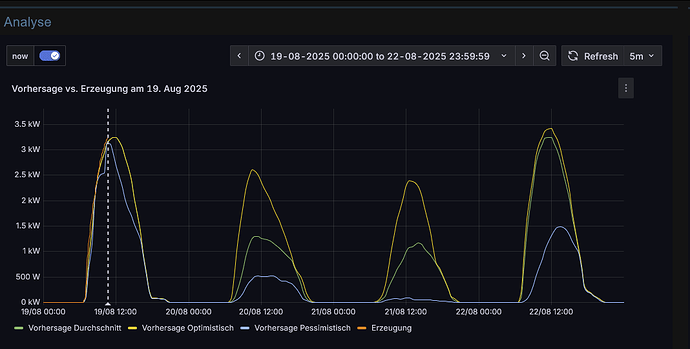

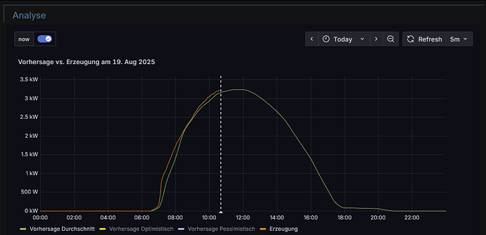

Not 100% sure. I simply use the raw data for visualization purposes in grafana. May be I’m lacking a piece of information but by means of the infinity plugin I can very easy visualize the forecast data up to 7 days ahead in a webview frame without the need to use rule actions or to fill a lot of data in my influx database. This keeps my solcast rule thanks to your binding very simple. Please correct me if I’m wrong. I agree this works well for simple visualization only not for more sophisiticated forecast scenarios. But for the moment that is all I need and so it would be a pity for me if you drop the raw data, since this would require to request them a second time from solcast. Am I the only one using raw data or are there others around in the community?

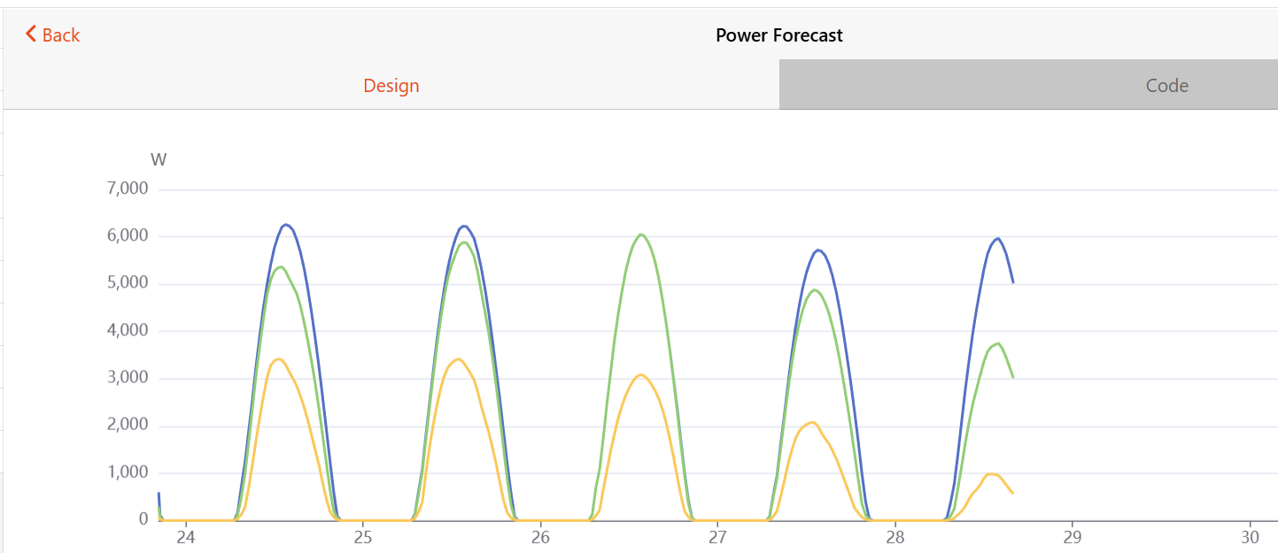

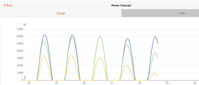

Just note raw channel is present for each plane but not for site. I’ve personally 2 planes so for me it is of minor initerest and I want to see the combined forecast. Also note if you’re using the inmemory persitence service without database storage it looks pretty well!
I also take care to keep my influxdb tidy. Just from my personal experience: I store a lot values in influxdb: weather forecast, solar forecast, heat pump, climate control, temperatures inside and outside, PV values per second, wallbox, white goods, …. and after 5 years I’ve 1.5 GB storage. On my sd card this can continue till I die.

I use one plane only, but to calculate the total of two planes is a simple transformation in Grafana too :slightly_smiling_face: . Thanks for the hint with the ‘inmemory persistance’, I wasn’t aware of that.
So, it would be great if you keep the channel, but if I’m the only one using it … Let me know, when you have found a decision.

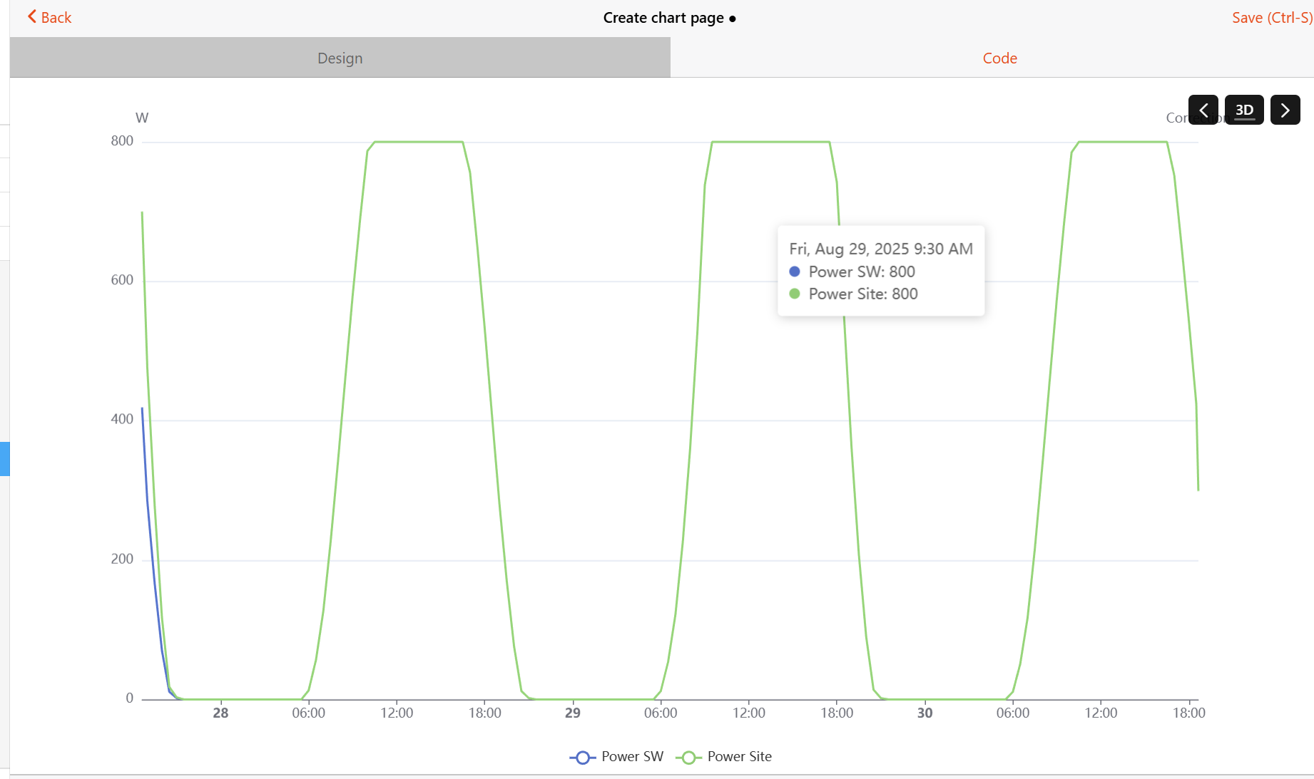

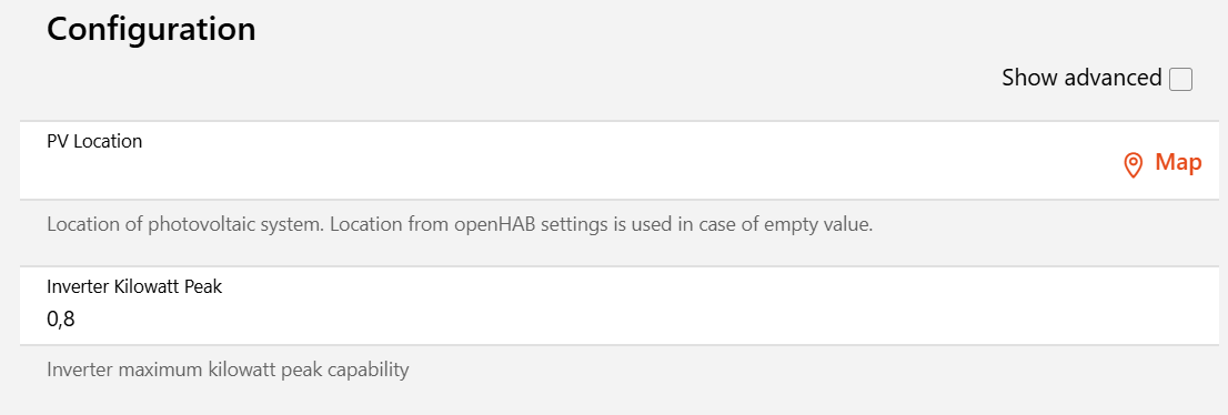

Where did you get that from?
I checked forecast.solar API docs but there’s no minimum defined and also binding readme nor code is requiring at least 1 kW.
Correct configuration is to set inverterKwp config property to 0,8 (comma) or in text config 0.8 (dot) and the forecast is cropped.
So you can configure a balcony power plant forecast as allowed in Germany with the inverter restricted to 800W while planes can have up to 2kWp.
PS:
Surprisingly my test failed with the official binding but this Marketplace version fixed this issue now!
