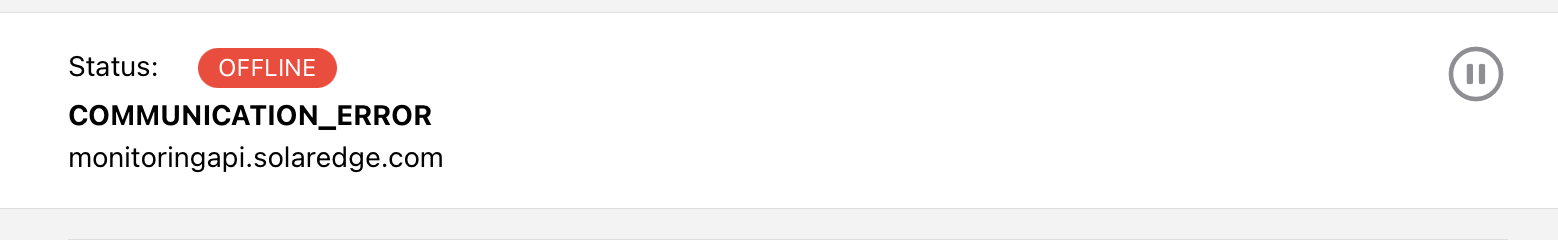

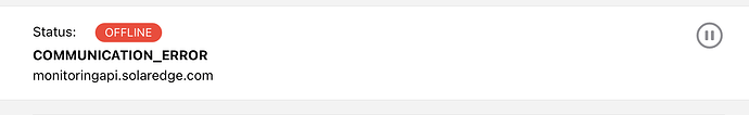

Around that time, I see the logical error lines in the logs that services can’t be reached. Where most add-ons just recover from this, I think the solaredge binding does not. However, events are still being logged. So for some reason I see this then:
I just rebooted my router yesterday after a firmware update and the binding reconnected just fine along with all my others, so I’m not sure this is the whole story. Are you using the experimental private API or the basic API settings?
