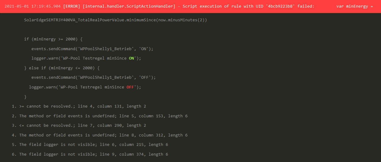

But get this…
2:0 Expected , but found if
^ in at line number 2 at column number 0
I checked different rules in the web. They all seem to be similar. Where is the mistake?
Isn’t there missing a closing ) in the var section? → …minus.Minutes(2)) But if I add a closing ), then I get this error:
ReferenceError: “SolarEdgeSEMTR3Y400VA_TotalRealPowerValue” is not defined in at line number 1
Hope someone can help… Thanks!

Alright, still using javascript so you will need to use PersistenceExtensions as per the example.
Note also that you can’t compare 500W with just 2000. 2000 what, kW, horsepower?
Copied the code into a new DSL-rule
Make your mind up. The javascript stuff like logger isn’t going to work in DSL either.
