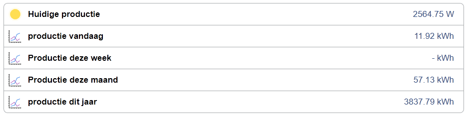

I installed the solaredge binding, programmed the thing-file, items-file and sitemap-file. All, except for the "channel=“solaredge:generic:se3300:aggregate_week#production”-readouts work wel. I don’t see enything wrong in the programming.
Am I forgetting something?
My items-list:
Number:Power se3300_live "Huidige productie [%.2f %unit%]" <sun> { channel="solaredge:generic:se3300:live#production" }
Number:Energy se3300_dagprod "Productie vandaag [%.2f kWh]" <line> { channel="solaredge:generic:se3300:aggregate_day#production" }
Number:Energy se3300_weekprod "Productie deze week [%.2f kWh]" <line> { channel="solaredge:generic:se3300:aggregate_week#production" }
Number:Energy se3300_maandprod "Productie deze maand [%.2f kWh]" <line> { channel="solaredge:generic:se3300:aggregate_month#production" }
Number:Energy se3300_jaarprod "Productie dit jaar [%.2f kWh]" <line> { channel="solaredge:generic:se3300:aggregate_year#production"}
My sitemap-list
        Text item=se3300_live
        Text item=se3300_dagprod
        Text item=se3300_weekprod
        Text item=se3300_maandprod
        Text item=se3300_jaarprod
The output
Does someone have any tips for where to look, what to change or what to add?

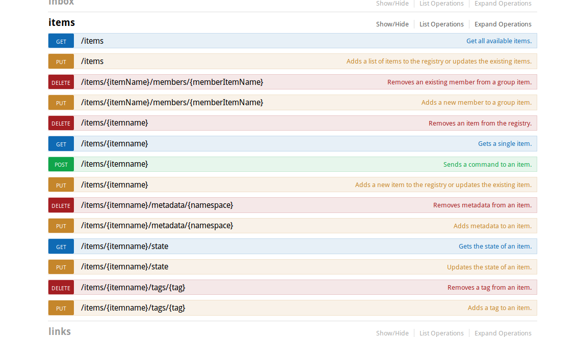

Go to the rest API from the dashboard
Click items
You get:
Go to the third GET

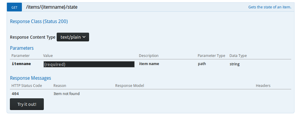

/items/{itemname}/state
Enter se3300_weekprod in the itemname field and click Try it out!
The API will respond with the state of the item
Good explanation!! thanks.
The response is:
The state is UNDEF
That’s the problem

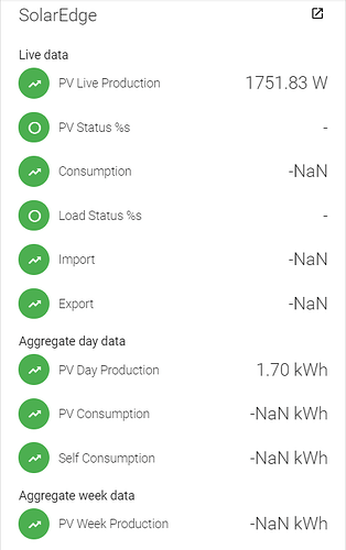

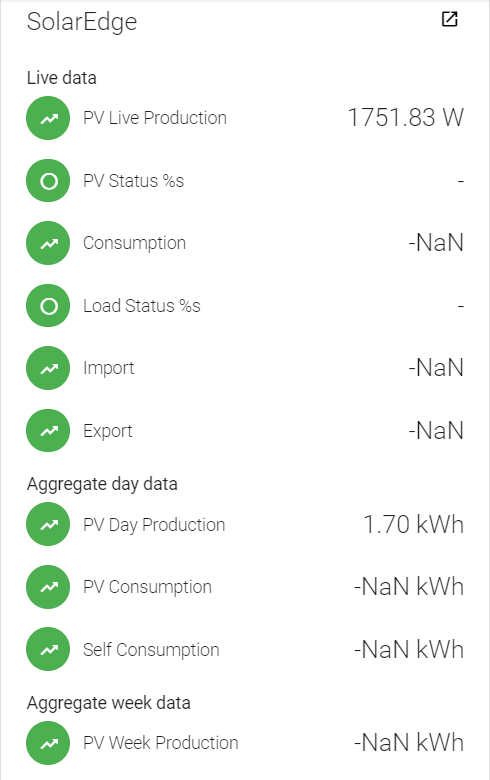

I think it is a problem with the binding - here’s a screenshot of mine from PaperUI:
(Month & Year, not visible here, do show a good value). I’m also not seeing anything in the Consumption fields, even though I have a Consumption meter attached to my SE inverter.

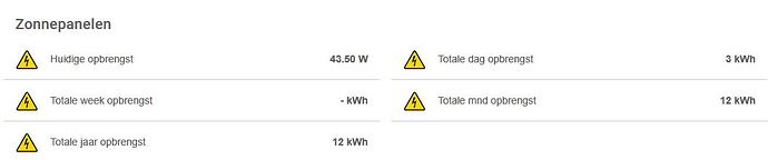

My readings:
