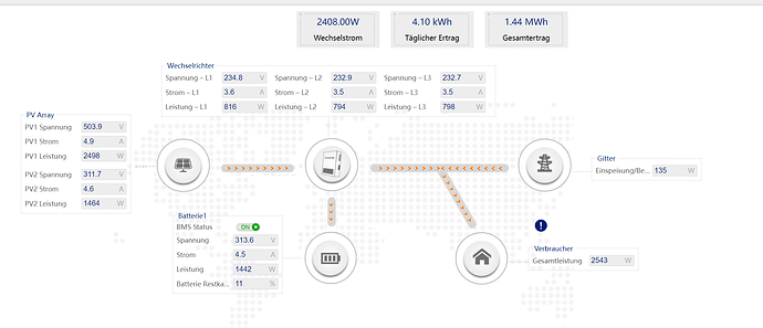

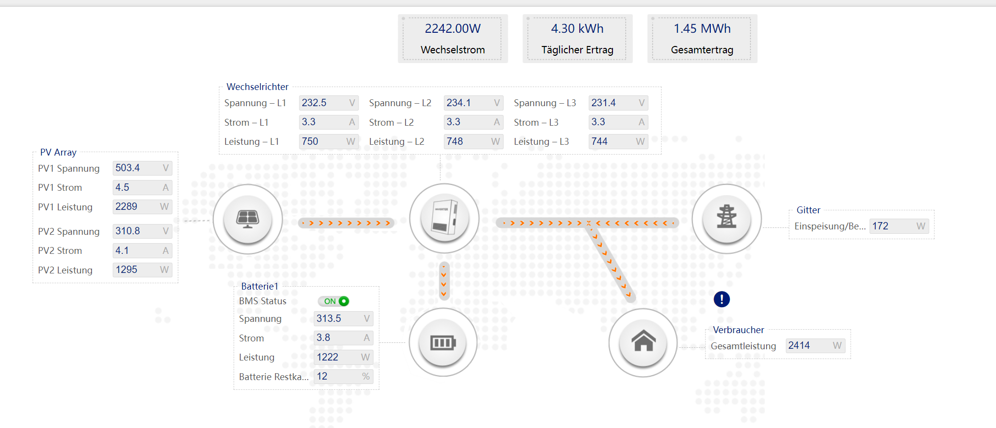

Good finding! We have to play a bit with this one… can you give me the full response + the expected value (according to you) so I can try to make a unit test for it?
Sure - here are 2 full responses - but currently i am a bit lost - seems now both values are 0?
{“sn”:“x”,“ver”:“3.005.01”,“type”:14,“Data”:[2352,2335,2329,34,34,34,783,761,767,2311,4881,3084,45,43,2242,1326,5003,5003,5002,2,0,0,0,0,0,0,0,0,0,0,0,0,0,1,0,0,0,0,0,31330,350,1127,3078,36,1108,1,48,2311,256,4151,7690,5896,100,0,44,0,0,0,0,0,0,0,0,0,0,0,0,0,14442,0,41,8,0,0,2601,0,2933,0,0,3,15425,0,45,7,0,0,62853,0,17337,0,0,0,786,0,0,0,0,0,0,0,0,0,1,11,1,35,10,256,3504,2400,300,183,292,275,32,32,30,1620,779,15163,15163,14906,0,0,0,3248,3241,47443,8,20564,12339,18753,12353,18742,12356,13625,20564,12339,18754,12866,18743,14151,13104,20564,12339,18754,12866,18743,14151,12592,20564,12339,18754,12865,18738,12871,13620,0,0,0,0,0,0,0,3587,258,1537,515,0,31330,0,0,0,0,0,0,0,0,0,0,0,0,0,0,0,0,0,0,0,0,0,0,0,0,0,0,0,0,0,0,0,0,0,0,0,0,0,0,0,0,0,0,0,0,0,0,0,0,0,0,0,0,0,0,0,0,0,0,0,0,0,0,0,0,0,0,0,0,0,0,0,0,0,0,0,0,0,0,0,0,0,0,0,0,0,0,0,0,0,0,0,0,0,0,0,0,0,0,0,0,0,0,0,0,0,0,0,0,0,0,0,0,0,0,0,0,0,0,0,0,0,0,0,0,0,0,0,0,0,0],“Information”:[12.000,14,“x”,8,1.23,0.00,1.24,1.09,0.00,1]} to {“sn”:“x”,“ver”:“3.005.01”,“type”:14,“Data”:[2347,2332,2324,35,34,35,800,781,784,2365,5027,3075,43,42,2206,1305,4998,4999,5000,2,0,0,0,0,0,0,0,0,0,0,0,0,0,1,0,0,0,0,0,31320,330,1064,3078,33,1015,1,48,2365,256,4358,7690,5896,100,0,44,0,0,0,0,0,0,0,0,0,0,0,0,0,14442,0,41,8,0,0,2601,0,2933,0,0,3,15426,0,46,7,0,0,62853,0,17337,0,0,0,786,0,0,0,0,0,0,0,0,0,1,11,1,35,10,256,3504,2400,300,183,292,275,32,32,30,1620,779,15163,15163,14906,0,0,0,3247,3240,47446,8,20564,12339,18753,12353,18742,12356,13625,20564,12339,18754,12866,18743,14151,13104,20564,12339,18754,12866,18743,14151,12592,20564,12339,18754,12865,18738,12871,13620,0,0,0,0,0,0,0,3587,258,1537,515,0,31320,0,0,0,0,0,0,0,0,0,0,0,0,0,0,0,0,0,0,0,0,0,0,0,0,0,0,0,0,0,0,0,0,0,0,0,0,0,0,0,0,0,0,0,0,0,0,0,0,0,0,0,0,0,0,0,0,0,0,0,0,0,0,0,0,0,0,0,0,0,0,0,0,0,0,0,0,0,0,0,0,0,0,0,0,0,0,0,0,0,0,0,0,0,0,0,0,0,0,0,0,0,0,0,0,0,0,0,0,0,0,0,0,0,0,0,0,0,0,0,0,0,0,0,0,0,0,0,0,0,0],“Information”:[12.000,14,“x”,8,1.23,0.00,1.24,1.09,0.00,1]}
{“sn”:“x”,“ver”:“3.005.01”,“type”:14,“Data”:[2337,2337,2315,34,33,34,765,749,750,2264,4978,3071,49,45,2480,1394,5001,5001,5000,2,0,0,0,0,0,0,0,0,0,0,0,0,0,1,0,0,0,0,0,31360,470,1505,3080,47,1447,1,48,2264,256,4644,7690,5896,100,0,44,0,0,0,0,0,0,0,0,0,0,0,0,0,14443,0,42,8,0,0,2601,0,2933,0,0,3,15426,0,46,7,0,0,62853,0,17337,0,0,0,786,0,0,0,0,0,0,0,0,0,1,12,1,35,11,256,3504,2400,300,186,291,275,33,32,30,1620,779,15163,15163,14906,0,0,0,3251,3244,47474,8,20564,12339,18753,12353,18742,12356,13625,20564,12339,18754,12866,18743,14151,13104,20564,12339,18754,12866,18743,14151,12592,20564,12339,18754,12865,18738,12871,13620,0,0,0,0,0,0,0,3587,257,257,515,0,31360,0,0,0,0,0,0,0,0,0,0,0,0,0,0,0,0,0,0,0,0,0,0,0,0,0,0,0,0,0,0,0,0,0,0,0,0,0,0,0,0,0,0,0,0,0,0,0,0,0,0,0,0,0,0,0,0,0,0,0,0,0,0,0,0,0,0,0,0,0,0,0,0,0,0,0,0,0,0,0,0,0,0,0,0,0,0,0,0,0,0,0,0,0,0,0,0,0,0,0,0,0,0,0,0,0,0,0,0,0,0,0,0,0,0,0,0,0,0,0,0,0,0,0,0,0,0,0,0,0,0],“Information”:[12.000,14,“x”,8,1.23,0.00,1.24,1.09,0.00,1]} to {“sn”:“x”,“ver”:“3.005.01”,“type”:14,“Data”:[2345,2334,2313,35,35,35,800,785,786,2371,4975,3067,49,45,2448,1388,5002,5002,5002,2,0,0,0,0,0,0,0,0,0,0,0,0,0,1,173,0,0,0,0,31350,400,1285,3079,41,1262,1,48,2198,256,4656,7690,5896,100,0,44,0,0,0,0,0,0,0,0,0,0,0,0,0,14443,0,42,8,0,0,2601,0,2933,0,0,3,15427,0,47,7,0,0,62853,0,17337,0,0,0,786,0,0,0,0,0,0,0,0,0,1,12,1,35,11,256,3504,2400,300,186,291,275,33,32,30,1620,779,15163,15163,14906,0,0,0,3250,3243,47479,8,20564,12339,18753,12353,18742,12356,13625,20564,12339,18754,12866,18743,14151,13104,20564,12339,18754,12866,18743,14151,12592,20564,12339,18754,12865,18738,12871,13620,0,0,0,0,0,0,0,3587,257,257,515,0,31350,0,0,0,0,0,0,0,0,0,0,0,0,0,0,0,0,0,0,0,0,0,0,0,0,0,0,0,0,0,0,0,0,0,0,0,0,0,0,0,0,0,0,0,0,0,0,0,0,0,0,0,0,0,0,0,0,0,0,0,0,0,0,0,0,0,0,0,0,0,0,0,0,0,0,0,0,0,0,0,0,0,0,0,0,0,0,0,0,0,0,0,0,0,0,0,0,0,0,0,0,0,0,0,0,0,0,0,0,0,0,0,0,0,0,0,0,0,0,0,0,0,0,0,0,0,0,0,0,0,0],“Information”:[12.000,14,“x”,8,1.23,0.00,1.24,1.09,0.00,1]}
screenshot:
Ok now i have again values - i guess the realtime data does not 100% correspond to the screenshot.
65494,
65535
{“sn”:“x”,“ver”:“3.005.01”,“type”:14,“Data”:[2340,2321,2326,36,36,36,824,804,810,2438,4995,3076,45,41,2297,1280,5000,5000,5001,2,0,0,0,0,0,0,0,0,0,0,0,0,0,1,65494,65535,0,0,0,31330,320,1034,3078,33,1015,1,48,2480,256,6181,7690,5896,100,0,45,0,0,0,0,0,0,0,0,0,0,0,0,0,14445,0,44,8,0,0,2601,0,2934,0,0,4,15430,0,50,7,0,0,62853,0,17337,0,0,0,786,0,0,0,0,0,0,0,0,0,1,13,1,35,12,256,3504,2400,300,189,291,275,32,32,30,1620,779,15163,15163,14906,0,0,0,3248,3241,47588,8,20564,12339,18753,12353,18742,12356,13625,20564,12339,18754,12866,18743,14151,13104,20564,12339,18754,12866,18743,14151,12592,20564,12339,18754,12865,18738,12871,13620,0,0,0,0,0,0,0,3587,257,1281,515,0,31330,0,0,0,0,0,0,0,0,0,0,0,0,0,0,0,0,0,0,0,0,0,0,0,0,0,0,0,0,0,0,0,0,0,0,0,0,0,0,0,0,0,0,0,0,0,0,0,0,0,0,0,0,0,0,0,0,0,0,0,0,0,0,0,0,0,0,0,0,0,0,0,0,0,0,0,0,0,0,0,0,0,0,0,0,0,0,0,0,0,0,0,0,0,0,0,0,0,0,0,0,0,0,0,0,0,0,0,0,0,0,0,0,0,0,0,0,0,0,0,0,0,0,0,0,0,0,0,0,0,0],“Information”:[12.000,14,“H34C12I8257105”,8,1.23,0.00,1.24,1.09,0.00,1]} to {“sn”:“x”,“ver”:“3.005.01”,“type”:14,“Data”:[2338,2321,2325,35,34,35,786,772,779,2337,4968,3069,46,41,2309,1285,5000,5000,5000,2,0,0,0,0,0,0,0,0,0,0,0,0,0,1,65475,65535,0,0,0,31340,350,1096,3078,35,1077,1,48,2398,256,6193,7690,5896,100,0,45,0,0,0,0,0,0,0,0,0,0,0,0,0,14445,0,44,8,0,0,2601,0,2934,0,0,4,15430,0,50,7,0,0,62853,0,17337,0,0,0,786,0,0,0,0,0,0,0,0,0,1,13,1,35,12,256,3504,2400,300,189,291,275,32,32,30,1620,779,15163,15163,14906,0,0,0,3248,3241,47591,8,20564,12339,18753,12353,18742,12356,13625,20564,12339,18754,12866,18743,14151,13104,20564,12339,18754,12866,18743,14151,12592,20564,12339,18754,12865,18738,12871,13620,0,0,0,0,0,0,0,515,257,1281,515,0,31340,0,0,0,0,0,0,0,0,0,0,0,0,0,0,0,0,0,0,0,0,0,0,0,0,0,0,0,0,0,0,0,0,0,0,0,0,0,0,0,0,0,0,0,0,0,0,0,0,0,0,0,0,0,0,0,0,0,0,0,0,0,0,0,0,0,0,0,0,0,0,0,0,0,0,0,0,0,0,0,0,0,0,0,0,0,0,0,0,0,0,0,0,0,0,0,0,0,0,0,0,0,0,0,0,0,0,0,0,0,0,0,0,0,0,0,0,0,0,0,0,0,0,0,0,0,0,0,0,0,0],“Information”:[12.000,14,“x”,8,1.23,0.00,1.24,1.09,0.00,1]}
