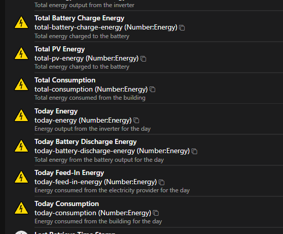

The interessting thing is now if i create the Local Connect Inverter thing from scratch - i get this in the logs:
2023-09-07 14:58:02.716 [WARN ] [re.thing.internal.ThingFactoryHelper] - Could not create channel ‘total-energy’, because channel type ‘system:energy’ could not be found.
2023-09-07 14:58:02.719 [WARN ] [re.thing.internal.ThingFactoryHelper] - Could not create channel ‘total-battery-discharge-energy’, because channel type ‘system:energy’ could not be found.
2023-09-07 14:58:02.721 [WARN ] [re.thing.internal.ThingFactoryHelper] - Could not create channel ‘total-battery-charge-energy’, because channel type ‘system:energy’ could not be found.
2023-09-07 14:58:02.723 [WARN ] [re.thing.internal.ThingFactoryHelper] - Could not create channel ‘total-pv-energy’, because channel type ‘system:energy’ could not be found.
2023-09-07 14:58:02.726 [WARN ] [re.thing.internal.ThingFactoryHelper] - Could not create channel ‘total-consumption’, because channel type ‘system:energy’ could not be found.
2023-09-07 14:58:02.728 [WARN ] [re.thing.internal.ThingFactoryHelper] - Could not create channel ‘total-feed-in-energy’, because channel type ‘system:energy’ could not be found.
2023-09-07 14:58:02.730 [WARN ] [re.thing.internal.ThingFactoryHelper] - Could not create channel ‘today-energy’, because channel type ‘system:energy’ could not be found.
2023-09-07 14:58:02.732 [WARN ] [re.thing.internal.ThingFactoryHelper] - Could not create channel ‘today-battery-discharge-energy’, because channel type ‘system:energy’ could not be found.
2023-09-07 14:58:02.735 [WARN ] [re.thing.internal.ThingFactoryHelper] - Could not create channel ‘today-battery-charge-energy’, because channel type ‘system:energy’ could not be found.
2023-09-07 14:58:02.737 [WARN ] [re.thing.internal.ThingFactoryHelper] - Could not create channel ‘today-feed-in-energy’, because channel type ‘system:energy’ could not be found.
2023-09-07 14:58:02.739 [WARN ] [re.thing.internal.ThingFactoryHelper] - Could not create channel ‘today-consumption’, because channel type ‘system:energy’ could not be found.
Yeah. I guess the old-metadata is still in place. Saw that a couple of times during the development of something. I changed it in the code but some stuff is old in the “thing” even though it was changed in the code. Usually if you delete the thing and recreate it, it works.

well it is a bit strange - with the thing which i created yesterday - it works if i manually change the type to energy. with the update from today - if i recreate the thing - i get those errors - and the new total’s channels are not visible at all :sleepy:
is system:energy the correct typeid for the channel?if i look here - Thing Descriptions | openHAB there is an system.electrical-energy - dont know if i look on the right pages :slight_smile:
Thanks for the notice… probably I have to change it to system.electrical-energy

damn - now the error says Cannot find channel type: system:electrical-energy :frowning:
Where is that? In the logs or in the UI? That’s strange… according to the thing type guide it should be there… :slight_smile:
i see it in the openhab.log - and the channels are not visible in the thing UI

ok - here we go - i modified the .jar archive - and updated the localConnectInverter.xml - the correct type is:
system.electric-energy
after that the channels are displayed correctly:

OK. I checked again… so in the documentation it’s electrical-energy but in the other channels the voltage and the current for example are electric-voltage/current. I have changed that to system.electric-energy.
Could you give it another try? (I have uploaded new jars in the same location)
