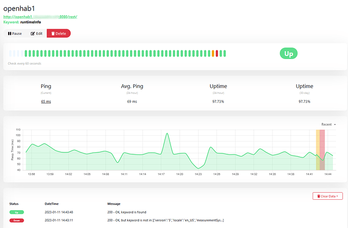

Another option that is much lighter resource/complexity than Zabbix (excellent system) but is still very capable, you can look at Uptime Kuma. It will run on just about anything including NAS appliances that support containers (QNAP, Synology, TrueNAS) GitHub - louislam/uptime-kuma: A fancy self-hosted monitoring tool
Here is a screenshot of one my openhab system services.

Which Method do you use? A normal HTTP-Request has no function on my system.
