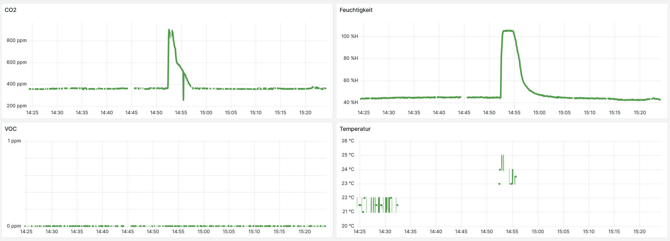

Final steps were creating the generic MQTT thing “Airbox” with channels for each measurement, adding the items to the persistence mapping and creating panels in Grafana, resulting in these nice charts.
