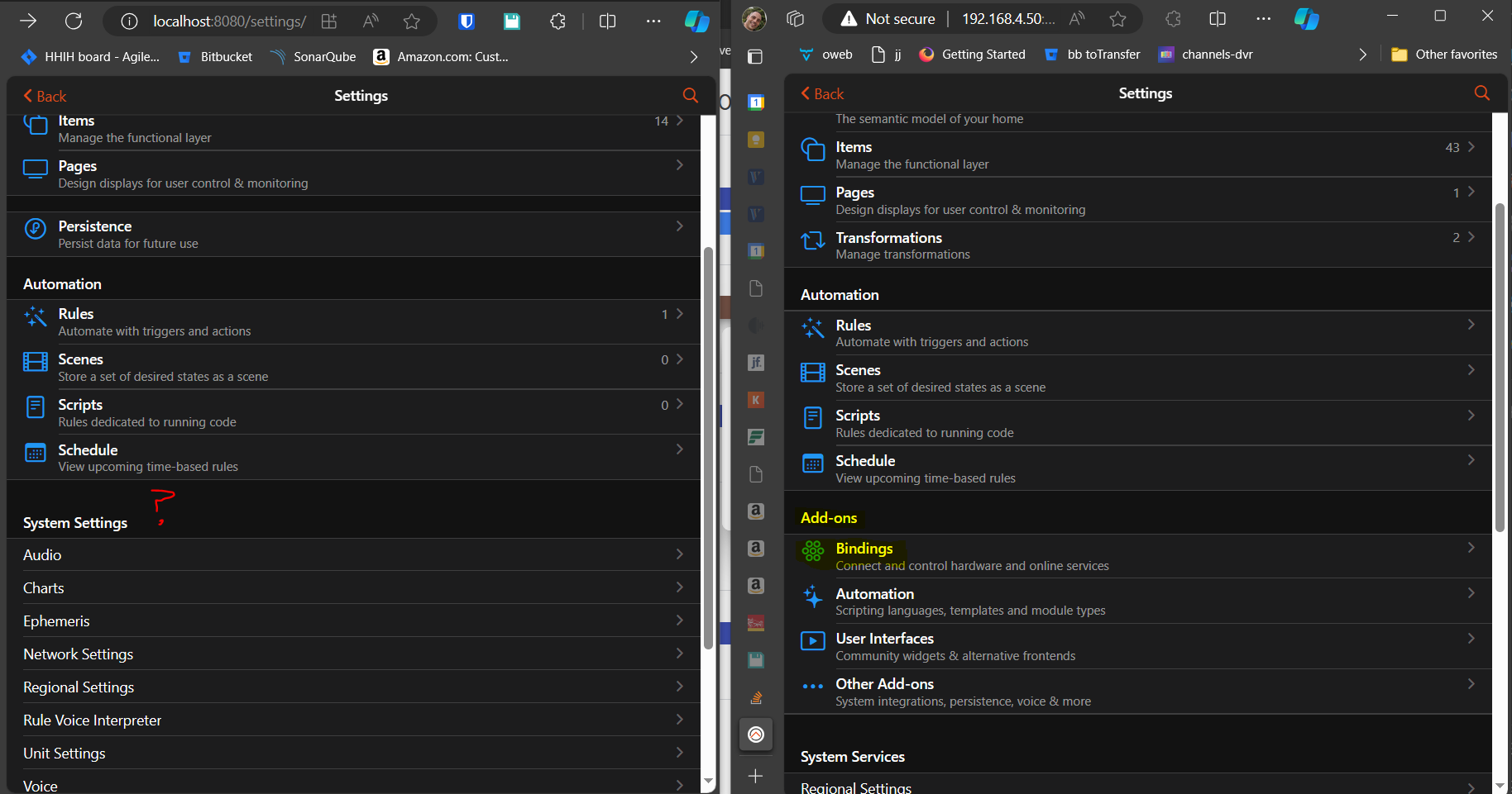

Another oddity is the entire “Binding” section is missing in the UI settings - not sure if that’s expected as a part of the 4.2.0 UI changes?
Here’s a comparison of eclipse/localhost to my production OH 4.0.x screen:

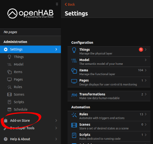

This all moved to an add-on store section:
@wborn Ah, got it. Appreciate the help!
