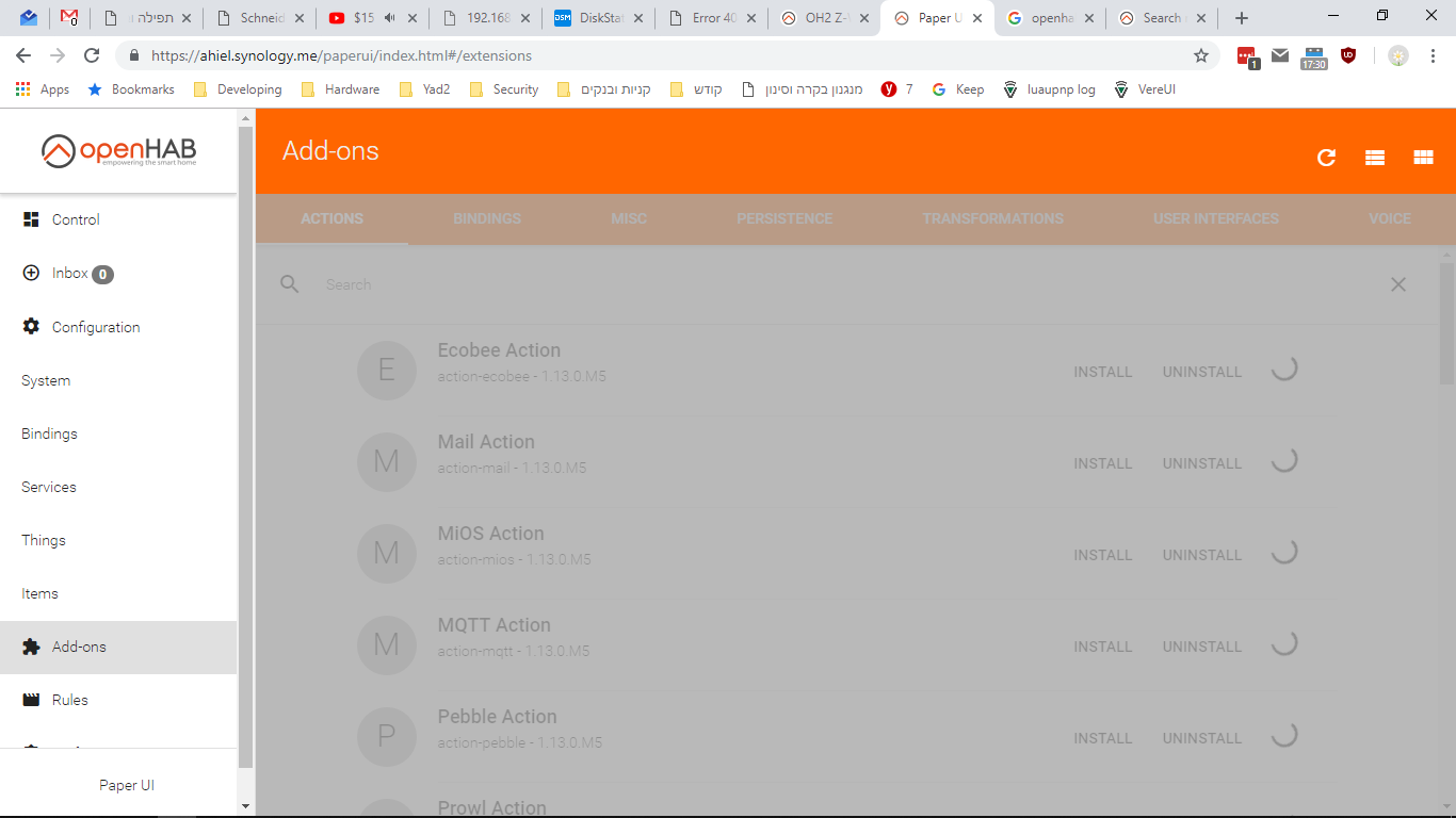

Hello
I’ve tried to install on docker openhab2.3 and 2.4.M5
after installing I see the addons page not loaded.
any ideas why?
tried to clean userdata directory ans still the same thing…

strange… I have never seen such gray overlay (or did you add this?) on the PaperUI and both Install and Uninstall options showing…
anything interesting in the logs?
did you deploy the offline-addons package also?
Didn’t deploy anything…
