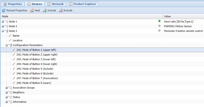

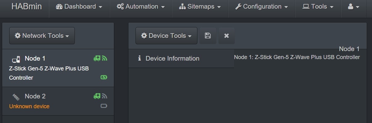

So I updated to the latest binding from cloud bees yesterday and updated the minimote firmware and it still doesn’t work but now I’m getting a lot of these messages in the log…
2016-01-05 21:27:42.555 TRACE o.o.b.z.i.protocol.ZWaveNode[:457]- NODE 3: App version requested but version is unknown
I’m about out of patience with this. It’s really frustrating to see other users that have this minimote working and I’ve spent so much time getting something so seemingly simple setup.
Any thoughts?
Does anyone see anything wrong with this?
Quick update: I put in a ticket with aeotec and they think the controller is bad so I’m sending it back to get another one. I’ll post what I find when I get the new one.
Update: Still need help!
Got my new minimote. Openhab can see it and it shows that I’ve pushed a button in the zwave log but the rule doesn’t fire.
There is no node2.xml created and it looks like the initialization of the node is never finished.
I’ve “force” woken the device a few times now and nothing changes.
I really need some guidance as to what I should try next. ZWAVE may be the death of me…

Were you able to set the “Secondary Controller Mode” configuration to “Scene Mode”? (This config is only in openhab 1.8)
I have the zwave binding snapshot from Jan 4, 2016. But I am still running OH 1.7.
I’ve attempted to set it but it keeps showing ‘update pending’. I’ve left it overnight and force woken the minimote with no change. Late yesterday I put habmin2 on the server (which is a really nice interface) and here is a screenshot.
I am getting the key presses in the zwave log but I don’t have a node.xml created for it. I’ve checked the permissions on the directory to make sure the openhab user can write and it can (it did create the node1.xml for the zwave dongle).
The minimote has version 1.19 firmware which is the latest (not sure when it was released though).
Any ideas would be great, I’ve wasted at least 3 days on this and I’m about burnt out on the idea of adding anything zwave.
So I would recommend updating to 1.8.
It is a pain in the butt getting the configuration changes to take. I
simply had to keep messing with it (waking it over and over etc). The
config will eventually take though.
Once you get that set to Scene Mode, you’re all set.
Thanks Kyle, I’ve update to 1.8 and restarted the service.
So should I just push the learn button for 3 secs over and over or should I just do it occasionally?
Everything else looks fine to you?
Another question - should it say that it’s power by MAINS… it is a battery device so I wondered if that may have anything to do with it having a hard time finishing initialization.
I’ve been working with an engineer from Aeotec for the past 17 days on this and he tells me that parameter 250 is set. On my minimote.

My Minimote doesn’t seem to get recognized properly (Node 2). I tried resetting both the Z-Stick and the Minimote but nothing worked. Also, no zwave xml is created for this particular remote. My Fibaro dimmer and motion sensor work fine before I resetted everything.
I’m using Openhab 1.7.1 (?)
Thanks for any help!
@Qris, to get mine to pick up the details of the minimote I had to hold the Join/Learn button for 3-4 seconds. Then it displayed that it was a minimote and showed a lot more details. I’ve yet to get mine to create a node xml file for the minimote but I’m not positive that it will because I was just told that it will never complete initialization.
Let me know if you get your minimote firing rules because I’ve been working on this for a month now.
@kyle, thanks. Do you think it’s a binding issue? Do you think I should create a bug? I’m not finding much about ‘Getting converter for item’. And I’ve noticed that in log before and searched on it in the past.
Thnx DMize,
First off, sorry for replying this late. I’m in building a new home, hence the use of domotics :wink:
Pressing the Learn button for a couple of seconds did the job on identifying the Minimote, at least to some extend. It shows up in my Devices tab but I can only see a couple of parameters (no parameter 250). I cannot change the settings.
In my terminal it says this when I press the learn button:
2016-02-06 11:35:19.309 [WARN ] [.o.b.z.i.p.c.ZWaveCommandClass] - NODE 3: Unsupported command class ASSOCIATION_COMMAND_CONFIGURATION
2016-02-06 11:35:19.346 [WARN ] [b.z.i.p.s.SendDataMessageClass] - NODE 3: Already processed another send data request for this callback Id, ignoring.
2016-02-06 11:35:24.313 [ERROR] [WaveController$ZWaveSendThread] - NODE 3: Timeout while sending message. Requeueing - 1 attempts left!
No problem, I’m still working on my issue too so I’m hoping that if we get yours working something will click with mine. I’ve now tried this zwave stick and minimote on three machines (1 Linux bare metal, 1 Linux vm, and 1 windows bare metal) and it has yet to work. I keep getting logs that have “Getting converter for item…” in them which I’m not seeing much info about.
For you to get the parameter 250 you need to update your zwave binding. You might as well grab the latest from the stable release or even the latest nightly build. https://openhab.ci.cloudbees.com/job/openHAB1-Addons/
Once that is loaded you should be able to see the parameter 250. Let me know how it goes.

So I updated the Z-Wave binding to 1.8.0. Still no luck getting all the parameters to show up. Only 241 till 248 are visible. The Minimote also doesn’t show any neighbours. Strange..
I’ll try to remove and re-add the Minimote once more.. If I could only get the thing to work, then I can hopefully help you with the rules. I’m also planning on using those, so I’ll do my very best :slightly_smiling:
In habmin on the left where it shows the binding names does it show you what version of the binding you have? I don’t see a spot where it shows the version number for habmin2. Maybe you have to copies of the binding and it’s using the wrong one? Updating my binding to 1.8.0 is what gave me the parameter 250. I don’t think the minimote will have neighbors because it’s not always listening so nothing will get routed through it other than the button presses from the remote itself.
Thanks for any help you can provide.
