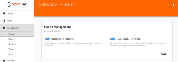

In PaperUI you need to enable legacy bindings it’s found in Configuration > System > Addon Management. Refresh the page and after that you will see the 1.x mqtt binding and can then install it.
Screenshot%20at%202019-01-19%2009-15-53
Make sure to click Save after enabling it.
I had a similar thing where after the last upgrade to 2.5.0 Legacy bindings was switched off instead of on.
Yep, legacy bindings turned off seems to be the default setting when upgrading.
