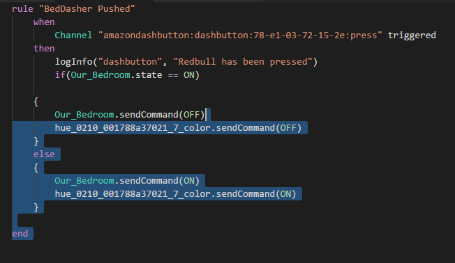

Hey all,
Hope everyone is having a great weekend. I’ve been able to battle my way through everything up until this point. I’m by no means a programmer, but after the upgrade to 2.3 I can’t get one of my dash buttons to turn off my light. I’m sure it’s something silly on my part. My first one with multiple lights works fine:
Not sure why this one doesn’t work in the rule. Every time i press in the logs it sends the command on.
Thank you!

Can you publish the relevant logs please?

Here is the log of pressing the dash button two times. Thanks so much
2018-06-09 12:12:39.706 [vent.ItemStateChangedEvent] - Bathroom_Cans changed from OFF to ON
2018-06-09 12:14:03.649 [me.event.ThingUpdatedEvent] - Thing 'zwave:device:ff15347c:node8' has been updated.
2018-06-09 12:15:12.829 [me.event.ThingUpdatedEvent] - Thing 'zwave:device:ff15347c:node20' has been updated.
2018-06-09 12:15:23.072 [vent.ItemStateChangedEvent] - EnergyMeter1_ElectricMeterWatts1 changed from 6.38 to 8.25
2018-06-09 12:15:48.134 [ERROR] [g.nest.handler.NestThermostatHandler] - Unsupported channelId 'time_to_target_mins'
2018-06-09 12:15:48.238 [ERROR] [g.nest.handler.NestThermostatHandler] - Unsupported channelId 'time_to_target_mins'
2018-06-09 12:15:48.265 [vent.ItemStateChangedEvent] - nest_thermostat_d6b49bb8_bGgroZy2vgckTV_qzcbERiaHtEs8rYDX_set_point changed from 66.0 to 70.0
2018-06-09 12:16:23.089 [vent.ItemStateChangedEvent] - EnergyMeter1_ElectricMeterWatts1 changed from 8.25 to 5.17
2018-06-09 12:16:23.204 [vent.ItemStateChangedEvent] - EnergyMeter1_ElectricMeterWatts2 changed from 9.35 to 5.83
2018-06-09 12:16:24.910 [me.event.ThingUpdatedEvent] - Thing 'zwave:device:ff15347c:node31' has been updated.
2018-06-09 12:17:17.354 [vent.ItemStateChangedEvent] - Our_Closet changed from ON to OFF
2018-06-09 12:17:22.603 [vent.ItemStateChangedEvent] - Bathroom_Cans changed from ON to OFF
2018-06-09 12:17:23.094 [vent.ItemStateChangedEvent] - EnergyMeter1_ElectricMeterWatts1 changed from 5.17 to 6.38
2018-06-09 12:17:37.512 [ERROR] [g.nest.handler.NestThermostatHandler] - Unsupported channelId 'time_to_target_mins'
2018-06-09 12:17:38.718 [ERROR] [g.nest.handler.NestThermostatHandler] - Unsupported channelId 'time_to_target_mins'
2018-06-09 12:18:23.113 [vent.ItemStateChangedEvent] - EnergyMeter1_ElectricMeterWatts1 changed from 6.38 to 5.17
2018-06-09 12:19:33.642 [ERROR] [g.nest.handler.NestThermostatHandler] - Unsupported channelId 'time_to_target_mins'
2018-06-09 12:20:23.213 [vent.ItemStateChangedEvent] - EnergyMeter1_ElectricMeterWatts2 changed from 5.83 to 6.82
2018-06-09 12:22:23.224 [vent.ItemStateChangedEvent] - EnergyMeter1_ElectricMeterWatts2 changed from 6.82 to 5.83
2018-06-09 12:23:40.236 [me.event.ThingUpdatedEvent] - Thing 'zwave:device:ff15347c:node8' has been updated.
2018-06-09 12:23:40.361 [me.event.ThingUpdatedEvent] - Thing 'zwave:device:ff15347c:node22' has been updated.
2018-06-09 12:25:23.245 [vent.ItemStateChangedEvent] - EnergyMeter1_ElectricMeterWatts2 changed from 5.83 to 6.82
2018-06-09 12:26:23.261 [vent.ItemStateChangedEvent] - EnergyMeter1_ElectricMeterWatts2 changed from 6.82 to 5.83
2018-06-09 12:27:20.148 [me.event.ThingUpdatedEvent] - Thing 'zwave:device:ff15347c:node20' has been updated.
2018-06-09 12:27:23.163 [vent.ItemStateChangedEvent] - EnergyMeter1_ElectricMeterWatts1 changed from 5.17 to 6.38
2018-06-09 12:27:23.260 [vent.ItemStateChangedEvent] - EnergyMeter1_ElectricMeterWatts2 changed from 5.83 to 3.19
2018-06-09 12:28:14.044 [ERROR] [g.nest.handler.NestThermostatHandler] - Unsupported channelId 'time_to_target_mins'
2018-06-09 12:28:14.099 [vent.ItemStateChangedEvent] - nest_thermostat_d6b49bb8_bGgroZy2vgckTV_qzcbERiaHtEs8rYDX_temperature changed from 68.0 to 69.0
2018-06-09 12:28:14.109 [ERROR] [g.nest.handler.NestThermostatHandler] - Unsupported channelId 'time_to_target_mins'
2018-06-09 12:28:32.190 [me.event.ThingUpdatedEvent] - Thing 'zwave:device:ff15347c:node31' has been updated.
2018-06-09 12:33:15.913 [me.event.ThingUpdatedEvent] - Thing 'zwave:device:ff15347c:node8' has been updated.
2018-06-09 12:35:47.583 [me.event.ThingUpdatedEvent] - Thing 'zwave:device:ff15347c:node22' has been updated.
2018-06-09 12:39:23.346 [vent.ItemStateChangedEvent] - EnergyMeter1_ElectricMeterWatts2 changed from 3.19 to 4.73
2018-06-09 12:39:27.632 [me.event.ThingUpdatedEvent] - Thing 'zwave:device:ff15347c:node20' has been updated.
2018-06-09 12:39:27.768 [vent.ItemStateChangedEvent] - zwave_device_ff15347c_node20_battery_level changed from 70 to 69
2018-06-09 12:40:39.614 [me.event.ThingUpdatedEvent] - Thing 'zwave:device:ff15347c:node31' has been updated.
2018-06-09 12:40:39.758 [vent.ItemStateChangedEvent] - FridgeWaterSensor_BatteryLevel changed from 88 to 92
2018-06-09 12:42:23.359 [vent.ItemStateChangedEvent] - EnergyMeter1_ElectricMeterWatts2 changed from 4.73 to 5.83
2018-06-09 12:42:54.298 [me.event.ThingUpdatedEvent] - Thing 'zwave:device:ff15347c:node8' has been updated.
2018-06-09 12:43:23.364 [vent.ItemStateChangedEvent] - EnergyMeter1_ElectricMeterWatts2 changed from 5.83 to 4.73
2018-06-09 12:45:23.374 [vent.ItemStateChangedEvent] - EnergyMeter1_ElectricMeterWatts2 changed from 4.73 to 3.19
2018-06-09 12:47:54.364 [me.event.ThingUpdatedEvent] - Thing 'zwave:device:ff15347c:node22' has been updated.
2018-06-09 12:47:54.503 [vent.ItemStateChangedEvent] - zwave_device_ff15347c_node22_battery_level changed from 87 to 89
2018-06-09 12:50:07.689 [ERROR] [g.nest.handler.NestThermostatHandler] - Unsupported channelId 'time_to_target_mins'
2018-06-09 12:50:07.761 [ERROR] [g.nest.handler.NestThermostatHandler] - Unsupported channelId 'time_to_target_mins'
2018-06-09 12:50:07.780 [vent.ItemStateChangedEvent] - nest_thermostat_d6b49bb8_bGgroZy2vgckTV_qzcbERiaHtEs8rYDX_temperature changed from 69.0 to 70.0
2018-06-09 12:50:07.801 [vent.ItemStateChangedEvent] - nest_thermostat_d6b49bb8_bGgroZy2vgckTV_qzcbERiaHtEs8rYDX_humidity changed from 40 to 45
2018-06-09 12:51:34.852 [me.event.ThingUpdatedEvent] - Thing 'zwave:device:ff15347c:node20' has been updated.
2018-06-09 12:52:23.322 [vent.ItemStateChangedEvent] - EnergyMeter1_ElectricMeterWatts1 changed from 6.38 to 5.17
2018-06-09 12:52:31.850 [me.event.ThingUpdatedEvent] - Thing 'zwave:device:ff15347c:node8' has been updated.
2018-06-09 12:52:46.384 [me.event.ThingUpdatedEvent] - Thing 'zwave:device:ff15347c:node31' has been updated.
2018-06-09 12:53:23.542 [vent.ItemStateChangedEvent] - EnergyMeter1_ElectricMeterWatts2 changed from 3.19 to 4.73
2018-06-09 12:53:46.319 [vent.ItemStateChangedEvent] - Our_Toilet changed from OFF to ON
2018-06-09 12:54:49.304 [vent.ItemStateChangedEvent] - Our_Toilet changed from ON to OFF
2018-06-09 12:55:23.342 [vent.ItemStateChangedEvent] - EnergyMeter1_ElectricMeterWatts1 changed from 5.17 to 6.38
2018-06-09 12:56:23.348 [vent.ItemStateChangedEvent] - EnergyMeter1_ElectricMeterWatts1 changed from 6.38 to 5.17
2018-06-09 12:56:23.443 [vent.ItemStateChangedEvent] - EnergyMeter1_ElectricMeterWatts2 changed from 4.73 to 5.83
2018-06-09 12:57:23.464 [vent.ItemStateChangedEvent] - EnergyMeter1_ElectricMeterWatts2 changed from 5.83 to 6.82
2018-06-09 12:58:07.611 [ERROR] [g.nest.handler.NestThermostatHandler] - Unsupported channelId 'time_to_target_mins'
2018-06-09 12:58:08.827 [ERROR] [g.nest.handler.NestThermostatHandler] - Unsupported channelId 'time_to_target_mins'
2018-06-09 12:58:08.894 [ERROR] [g.nest.handler.NestThermostatHandler] - Unsupported channelId 'time_to_target_mins'
2018-06-09 12:58:23.360 [vent.ItemStateChangedEvent] - EnergyMeter1_ElectricMeterWatts1 changed from 5.17 to 6.38
2018-06-09 12:58:23.458 [vent.ItemStateChangedEvent] - EnergyMeter1_ElectricMeterWatts2 changed from 6.82 to 4.73
2018-06-09 12:59:23.545 [vent.ItemStateChangedEvent] - EnergyMeter1_ElectricMeterWatts2 changed from 4.73 to 3.19
2018-06-09 13:00:01.409 [me.event.ThingUpdatedEvent] - Thing 'zwave:device:ff15347c:node22' has been updated.
2018-06-09 13:00:07.289 [vent.ChannelTriggeredEvent] - amazondashbutton:dashbutton:78-e1-03-72-15-2e:press triggered
2018-06-09 13:00:07.303 [INFO ] [se.smarthome.model.script.dashbutton] - Redbull has been pressed
2018-06-09 13:00:07.332 [ome.event.ItemCommandEvent] - Item 'Our_Bedroom' received command ON
2018-06-09 13:00:07.345 [ome.event.ItemCommandEvent] - Item 'hue_0210_001788a37021_7_color' received command ON
2018-06-09 13:00:07.356 [vent.ItemStateChangedEvent] - Our_Bedroom changed from 0 to 100
2018-06-09 13:00:07.365 [vent.ItemStateChangedEvent] - hue_0210_001788a37021_7_color changed from 254,98,0 to 254,98,100
2018-06-09 13:00:08.764 [vent.ItemStateChangedEvent] - hue_0210_001788a37021_7_color changed from 254,98,100 to 254,98,29
2018-06-09 13:00:39.389 [vent.ChannelTriggeredEvent] - amazondashbutton:dashbutton:78-e1-03-72-15-2e:press triggered
2018-06-09 13:00:39.406 [INFO ] [se.smarthome.model.script.dashbutton] - Redbull has been pressed
2018-06-09 13:00:39.425 [ome.event.ItemCommandEvent] - Item 'Our_Bedroom' received command ON
2018-06-09 13:00:39.442 [ome.event.ItemCommandEvent] - Item 'hue_0210_001788a37021_7_color' received command ON
2018-06-09 13:00:39.450 [vent.ItemStateChangedEvent] - hue_0210_001788a37021_7_color changed from 254,98,29 to 254,98,100

Do you by any change put autoupdate="false" in the definition of Our_Bedroom?
Can I see the definition of Our_Bedroom, please?

Our_Bedroom was created in Paper UI so if I understand correctly there is no definition or ability to add the autoupdate=“false”. This is just based on my reading, do you want me to screenshot the item in PaperUI?

Here is your clue:
Our_Bedroom is not a switch is it?
Then:
rule "BedDasher Pushed"
Channel "amazondashbutton:dashbutton:78-e1-03-72-15-2e:press" triggered
logInfo("dashbutton", "Redbull has been pressed")
if (Our_Bedroon.state > 0) {
Our_Bedroom.sendCommand(OFF)
hue_0210_001788a37021_7_color.sendCommand(OFF)
} else {
Our_Bedroom.sendCommand(ON)
hue_0210_001788a37021_7_color.sendCommand(ON)

Brilliant. It works like a champ now. Thank you so much for continuing to follow through on this vzorglub. I’ll watch for those dimmers in future rules that I use
Mike
