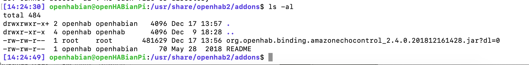

Check the permissions for the jar file and make sure you have uninstalled the binding via PaperUI before adding the jar file.

I have checked this as you suggested and got the output below.
I noticed I had the old Amazon Account Thing still on PaperUI - I wonder whether this would have disrupted something? If so any idea what I would need to put in the ssh terminal to uninstall the file so I can reinstall it?
The jar file is owned by root, needs to be openhab. Use sudo chown openhab org.openha.binding.amazonchontol_2.4.0.201812161428.jar check for typo;s in the file name, it’s a bit hard to read.:wink:

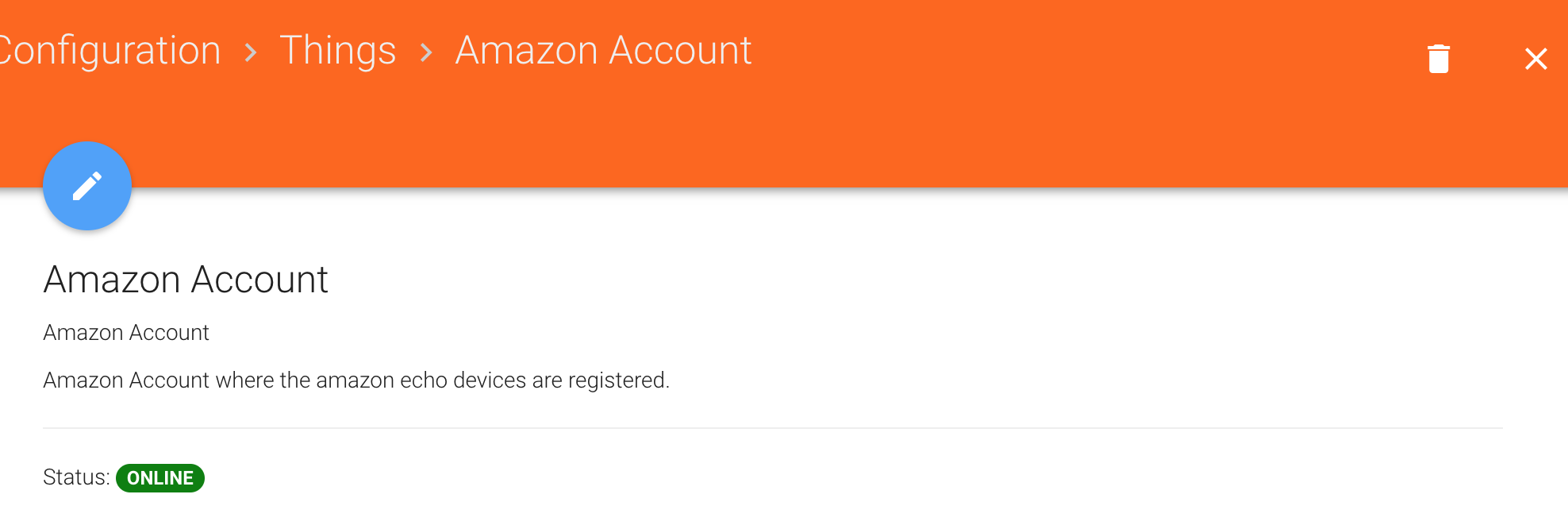

Thank you so much H102! :heart_eyes:
Managed to get to this bit so fingers crossed I can figure the rest out. Seems it was just the permissions.
