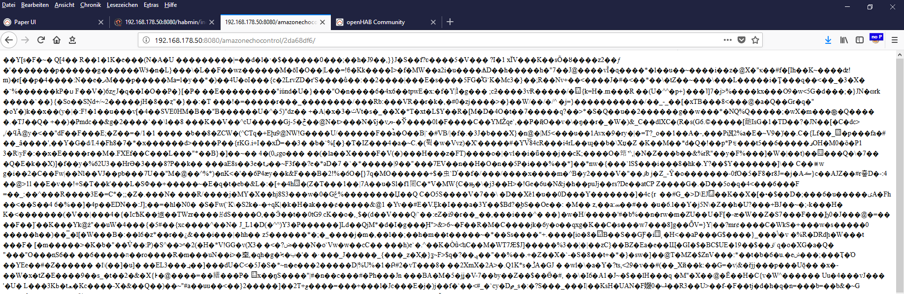

When I open
http://192.168.178.50:8080/amazonechocontrol/
and then open the amazon account I get a lot of rubbish:

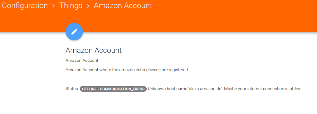

in Paper UI I have put the correct user / password, but see that alexa.amazon.de is not available (in reality it is though):
Anyone else with this issue?
is this related to: Release Candidate and Support: Amazon Echo Control Binding - #1067 by michi ?
It is!
Thanks a lot.
