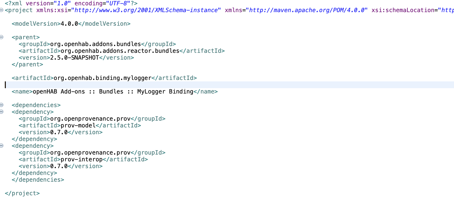

which is loacted in the maven central? I only add the necessary maven dependencies into my pom.xml, which is shown in ProvToolbox Tutorial 1: Creating and Saving a PROV Document | Luc's Blog. And now my pom.xml is shown like this:

What makes things strange is that, as long as I add the external maven dependencies into the pom.xml, the error will happen. As long as I comment those external dependencies, the error disappeared. And I can’t figure out what is related with
org.apache.commons.cli
Can someone give me some hints, such that I can include the ProvToolbox successfully? Thanks!
