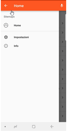

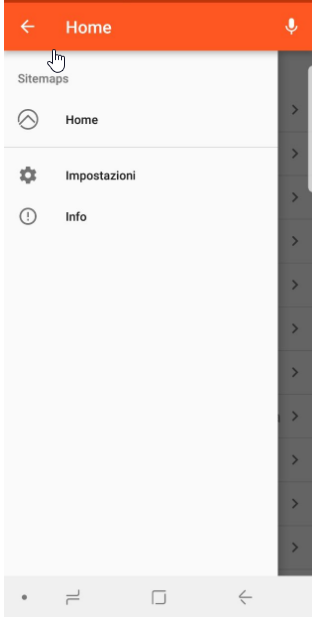

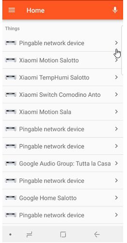

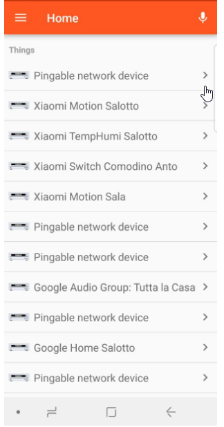

since a couple of days, my OpenHab App, do not show me my sitemap anymore, but show me a full list of the things i have on my system but I do not have my sitemap anymore.
