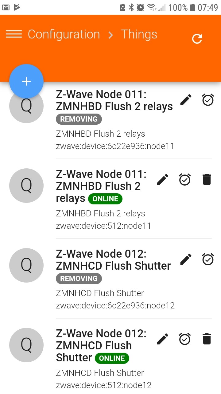

Could you post a screen shot. I’m not sure what you mean by the wrong names. It sounds like you added another controller with a different ThingID than before, so new Things were created or your devices. What error do you get in the log when you try to delete them?
Yes, I did delete my Z-stick because for some reason the name changed and I had to change the name of all my Things. So I deleted the Z-stick, re-entered it while changing the name.
When I again try to remove node 32, paperUI gives me a warring:
The thing is currently in the reviving state and the binding had not yet confirmed that the device had been removed successfully.
If you now click on remove, it will be removed without further communication to the binding.
But this never happens.
There is no error in my log.
Omg, it DOES remove the thing now!
I don’t understand why it didn’t before, but it’s working now. Thanks for making me try one more time!
