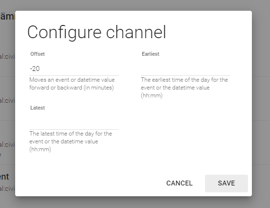

Offset I have specified here:

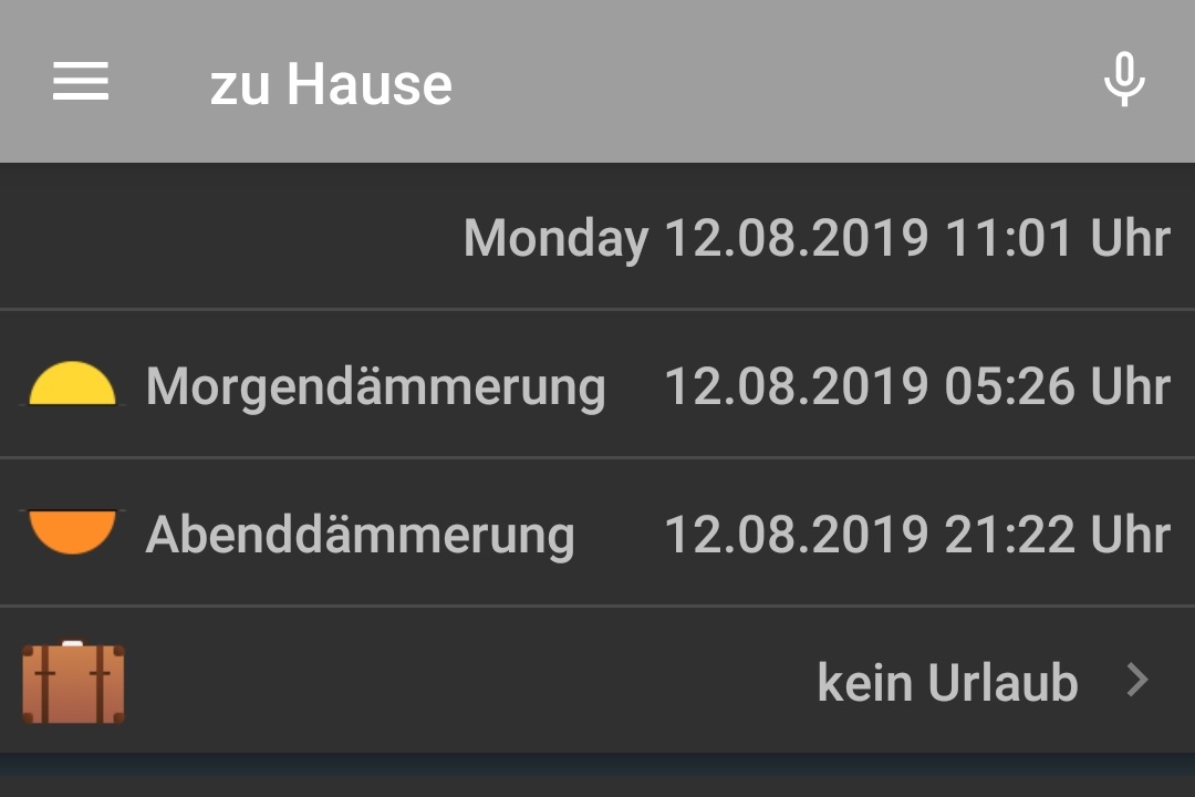

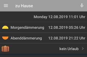

The offset is calculated correctly on the sitemap:
Text item=astro_Sonnenuntergang						icon="sunset"

The offset does not apply to astro:sun:local:civilDusk
It applies to astro:sun:local:civilDusk#end
If you want to offset astro:sun:local:civilDusk#event you must do that separately; it can be a different offset.
