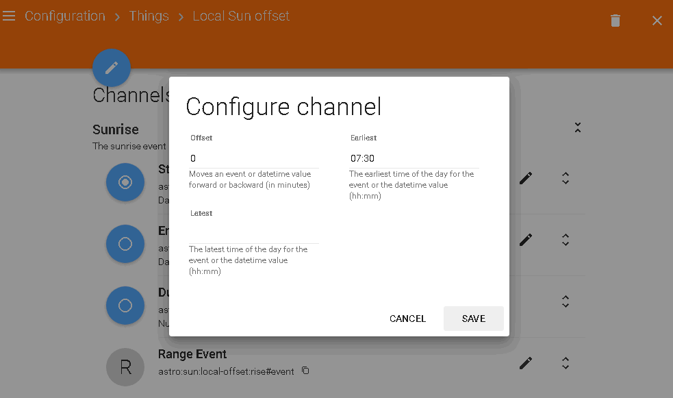

Channel configuration (Paperui):

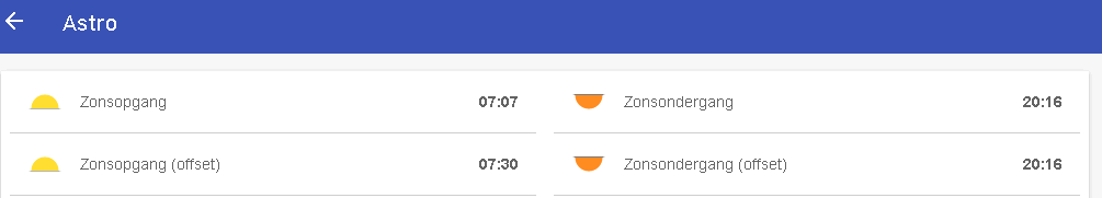

What is the problem: as you can see, the time of the sunrise offset (Zonsopgang (Offset)) is set at 7:30, as it suppose to be. But the rule is trigger at 7:07 (the normal sunrise).
The trigger statement of the channel does not honor the early offset configured in PaperUI, the item created with this channel does.

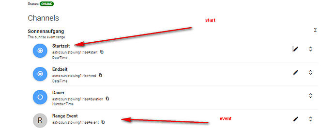

To which Channel you gave the Offset (earliest 7.30) ? To the Start-Channel or the Range Event-Channel ? It should be the Range-Event-Channel !
grafik
Another idea if your using the Range-Event-Channel:
As you can see in the example of @HomeAutomation the Time has a leading Zero (09:00). Have you tried it in the same way ?
When testing your options in this post I first run in the same problem, when defining the time in this way earliest=“9:00”, but it has to be earliest="09:00
Yes, thank you @fibu-freak! I think that’s the problem. I’ll correct it and we will see what happening tomorrow :wink:
The leading zero, I know, PaperUI gives an error if you type it without the leading zero.
