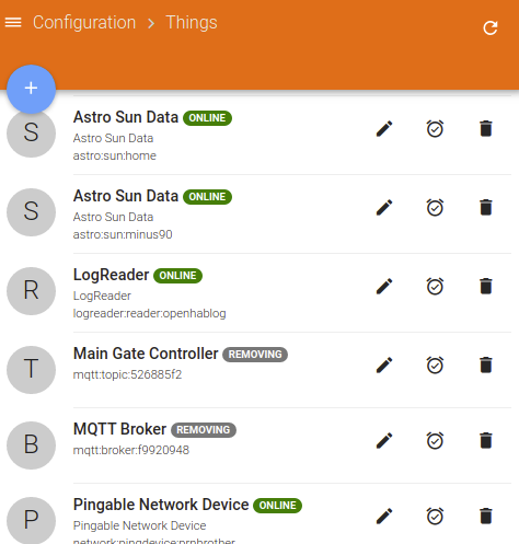

I used PaperUI to create the broker thing and one generic thing.
Now I am trying to delete them and can’t get rid of it.
I restarted OH, then these two tings come back as uninitialised, and when hitting the bin, they sit on removing forever.
In my books this is not how the system should behave, and why I am so cautious about using the UI.
[edit/update] There is a force remove option in PaperUI, which got rid of both.
