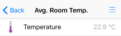

Under group overview I have Average room temperature which is collecting all temperature readings and dividing by total qty. I believe this aver room temp was copied from demo house.
Capture1
Now because I have one sensor which is located outside and also using weather binding my room temperature is naturally lowered. Currently I only have one sensor at home.
Questions is , how to separate indoor and outdoor reading to avoid this situation ? And also where is this average temperature calculated ?

So to leave outside temperature out, don’t include that Item in that Group
Thanks that worked.

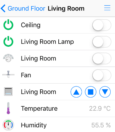

I have divided my house into separate rooms. So for example when I look into Living room tab I will see various items , switches, temperature , humidity etc.
Problem I have , when go to Group tab and look inside Avr room temperature or other like (door for example) I will see multiple items with the same name - Temperature or Door unless I add Living room name to this item. Is there any work around and will I need to name every item starting with location "Living room Door"and so on.

Write the labels one by one in the sitemap… I am afraid but that’s the only way
Well… Almost… You could also change the labels for each items in the item definition but then when you go into the group ‘Living room’ you will see ‘LivingRoom Temp’…
