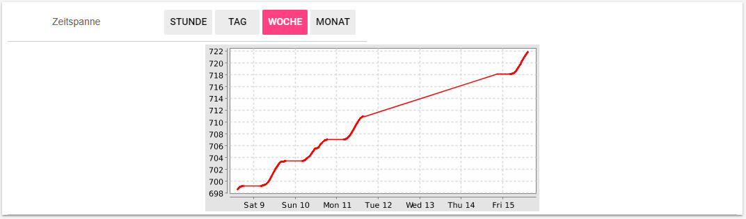

I updated openhab from 2.2 to 2.3 yesterday. The upgrade itself went without any trouble, but I have a chart for energy monitoring a Fritz! DECT 210 device via the AVM FRITZ! Binding.
Before the numeric value was around 700 kWh after the upgrade it changed to 700.000 kWh, see screenshot below:
I went into the settings for the Fritz! DECT device and changed the value to “Energy” and changed the global numeric system to “metric”, this did not change anything.
How can I fix this, and is there a way to get the scale back to normal without the jump after it is fixed?

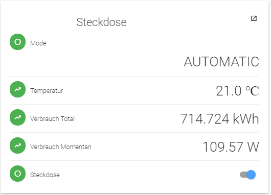

Here is a screenshot of the item in the “Control”-Section:
The “Verbrauch Total”-value is incorrect (should be 714,72 kWh), the “Verbrauch Momentan”-value is correct.

Because the temperature is 21°, you use decimalpoint. So it is 714 kWh.

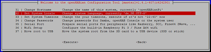

First I would change the system locale to de, to get the decimal komma in the output. If you use openHABian you can do that

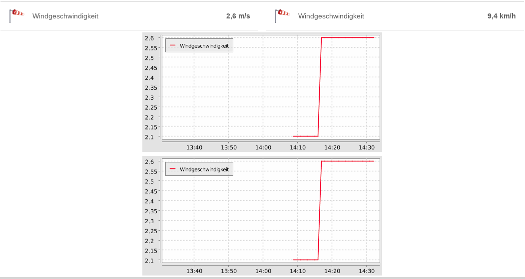

@northy Let my explain the issue we are facing a little bit more in detail. I have observed it in my environment for a different item too.
Lets assume we have a Number:Speed item which we want to display in the default speed unit (m/s) and in a different unit (km/h). For both units we want to have a chart in our sitemap. Which currently seems not to be possible.
Number:Speed testNumberSpeed
sitemap demo label="My home automation" {
    Frame label="Speed" {
        Text item=testNumberSpeed label="Windgeschwindigkeit [%.1f %unit%]" icon="wind"
        Text item=testNumberSpeed label="Windgeschwindigkeit [%.1f km/h]" icon="wind"
        Chart item=testNumberSpeed label="Windgeschwindigkeit [%.1f %unit%]" period=h legend=true
        Chart item=testNumberSpeed label="Windgeschwindigkeit [%.1f km/h]" period=h legend=true
