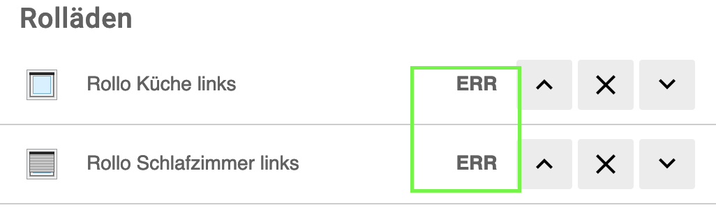

Hi all,
it is most probably a stupid question but I’ve currently no idea where it comes from.
In the sitemap I’ve set the rollershutter as default item:
Default item=EG_Rollo_Schlafzimmer_Rechts
Does anybody know where the “ERR” comes from and how to control or remove it.
Thanks.
Becksen

 Frame label="Rolläden" {
    Default item=EG_Rollo_Kueche_Links
    Default item=EG_Rollo_Kueche_Rechts
    Default item=EG_Rollo_Schlafzimmer_Links
    Default item=EG_Rollo_WZ_Links
    Default item=EG_Rollo_WZ_Rechts
    Default item=EG_Rollo_AZ
Rollershutter EG_Rollo_Kueche_Links "Rollo Küche links" {channel="homematic:HG-HM-LC-Bl1PBUFM:1c2190fb:OEQ:1#LEVEL"}
Rollershutter EG_Rollo_Kueche_Rechts "Rollo Küche rechts" {channel="homematic:HG-HM-LBl1PBU-FM:1c2190fb:OEQ:1#LEVEL"}
Rollershutter EG_Rollo_Schlafzimmer_Links "Rollo Schlafzimmer links" {channel="homematic:HG-HM-LC-Bl1PBU-FM:1c2190fb:OEQ:1#LEVEL"}
Rollershutter EG_Rollo_Schlafzimmer_Rechts "Rollo Schlafzimmer rechts" {channel="homematic:HG-HM-LC-Bl1PBU-FM:1c2190fb:OEQ:1#LEVEL"}
Rollershutter EG_Rollo_WZ_Links "Rollo Wohnzimmer links" {channel="homematic:HG-HM-LC-Bl1PBU-FM:1c2190fb:OEQ:1#LEVEL"}
Rollershutter EG_Rollo_WZ_Rechts "Rollo Wohnzimmer rechts" {channel="homematic:HG-HM-LC-Bl1PBU-FM:1c2190fb:OEQ:1#LEVEL"}
Rollershutter EG_Rollo_AZ "Rollo Arbeitszimmer" {channel="homematic:HG-HM-LC-Bl1PBU-FM:1c2190fb:OEQ:1#LEVEL"}

I found something in the logs. But I don’t know why it tries a transform operation:
2019-02-15 23:36:22.890 [WARN ] [ui.internal.items.ItemUIRegistryImpl] - Exception while formatting value '0' of item EG_Rollo_Kueche_Links with format '%.2f %unit%': Conversion = 'u'

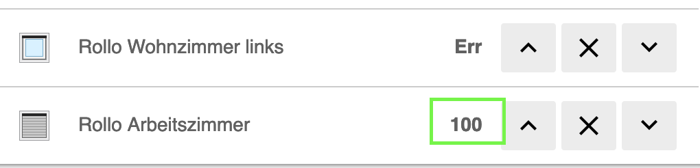

I found a solution now:
Define the item not with LEVEL but with DIRECTION:
Rollershutter EG_Rollo_AZ "Rollo Arbeitszimmer" {channel="homematic:HG-HM-LC-Bl1PBU-FM:1c2190fb:OEQXXXXXX:1#DIRECTION"}
In the sitemap it can be used as default and will show you the percentage value how far the blind is closed:
Now it looks nice :slight_smile:
Thanks you both for your ideas and effort!

DIRECTION does not give you the possibility to change LEVEL via Alexa. I found out that the default formatting of the value is the root cause. So I changed the label to include a formatter for the value:
rollershutter.items:
Rollershutter   FF_Hallway_Warema         "Warema Empore [%.0f %%]" <rollershutter> (FF_Hallway, gWarema)    ["Switchable"]        {channel="homematic:HM-LC-Bl1PBU-FM:3da6a785:LEQ1XXXXX:1#LEVEL"}
rollershutter.sitemap:
Default item=FF_Hallway_Warema label="Empore [%.0f %%]"
