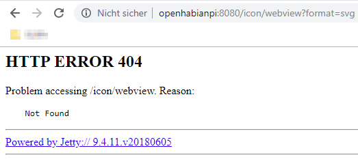

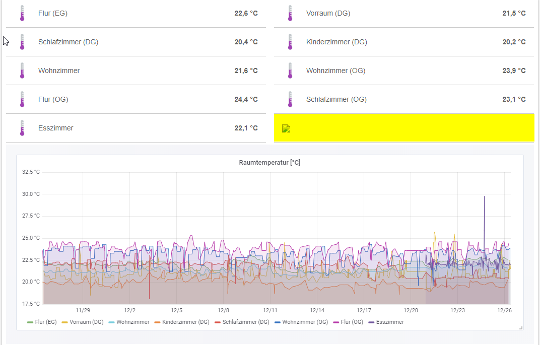

after upgrading to OH 2.4 i see a “not found” icon whithin my sitemap where a webview item is configured.
Screenshot:
Sitemap:

Webview url="http://openhabianpi:3000/d/ioB0_uWgk/raumtemperatur?edit&orgId=1&kiosk&theme=light&from=now-30d&to=now" height=11
When I look for the properties of this icon, it shows me:
Any ideas?
This wasn’t the case with OH 2.3…so something might have been changed or I am using the webview item the wrong way?
Label and icon were added to the webview widget. They were considered as missing.

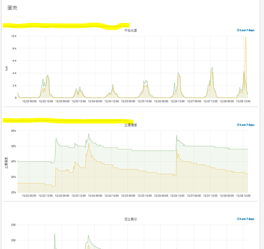

Do you mean add icon=none at “Configure Basic UI”? as I only have iconType, I change the value to none at advance mode and add icon=none as well, but issue still remain? any idea? when first load to page will have broken img icon, reload will invisible.
at browser console still able found 404 warn %E5%9C%96%E7%89%87
I also found that chart come with a line it only will dispear when chart have 3 or more in one page then last chart won’t have a line

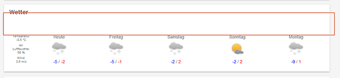

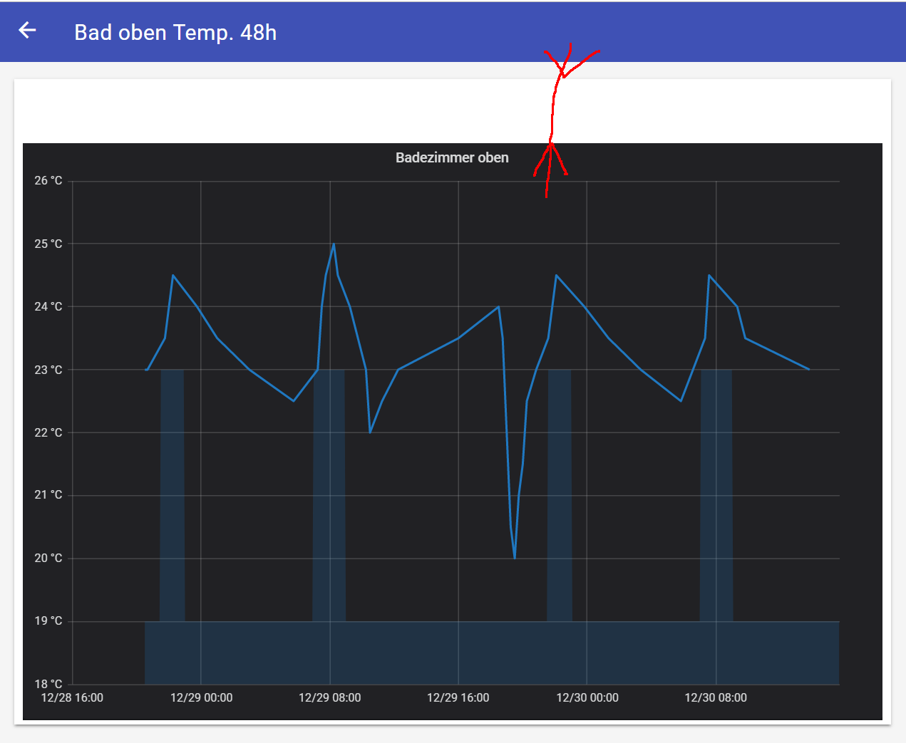

Well, I tried a transparent icon with 64x1 size, yet while this makes the visual icon disappear, the empty line for the icon still persists. Is there any way to also get rid of this empty line?
Can we see?
Sure, here we go.
You can define the height of the webview in the sitemap.
https://www.openhab.org/docs/configuration/sitemaps.html#element-type-webview

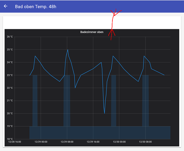

i’m not quite sure if that’s really the solution?
The webview now comes like any other item.
Therefore it reserves a “slot” in the basic UI where usually the items definition comes (like ON/OFF for switches and the item label).
I think that’s the white gap we’re seeing in the picture above, but i can’t tell if that was the same in OH 2.3
Resizing the Webview would just expand it more to the bottom
The height of the webview item refers to the whole thing, not to the one line that I am trying to get rid of. If I would set it to height=1 then I would only see the empty line, and nothing of the embedded web elements.
