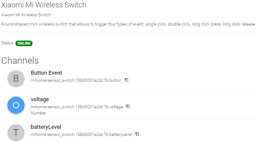

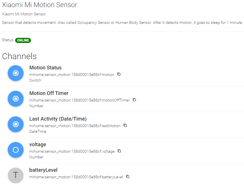

Yes, sorry. This is what I see in the two things in Paper UI:
motion-sensor
wireless-switch

P.S. Just saw that all your sensors only have their own device IDs showing in Paper UI. All my Xiaomi sensors have gatewayID:deviceID, e.g.
mihome:sensor_motion:03CADBF68DfA:325743ddca:batteryLevel
etc.
THis is also how it’s described in the binding docs which you linked to
....:<GwID>:<ID>:....
