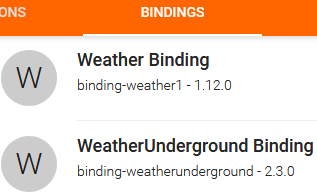

I think it’s the name you see at the PaperUI
Ok thank you. This will solve my problem with weatherunderground, and I will be able to read it in the PaperUI as well now, so it won’t be an issue for myself anymore now.

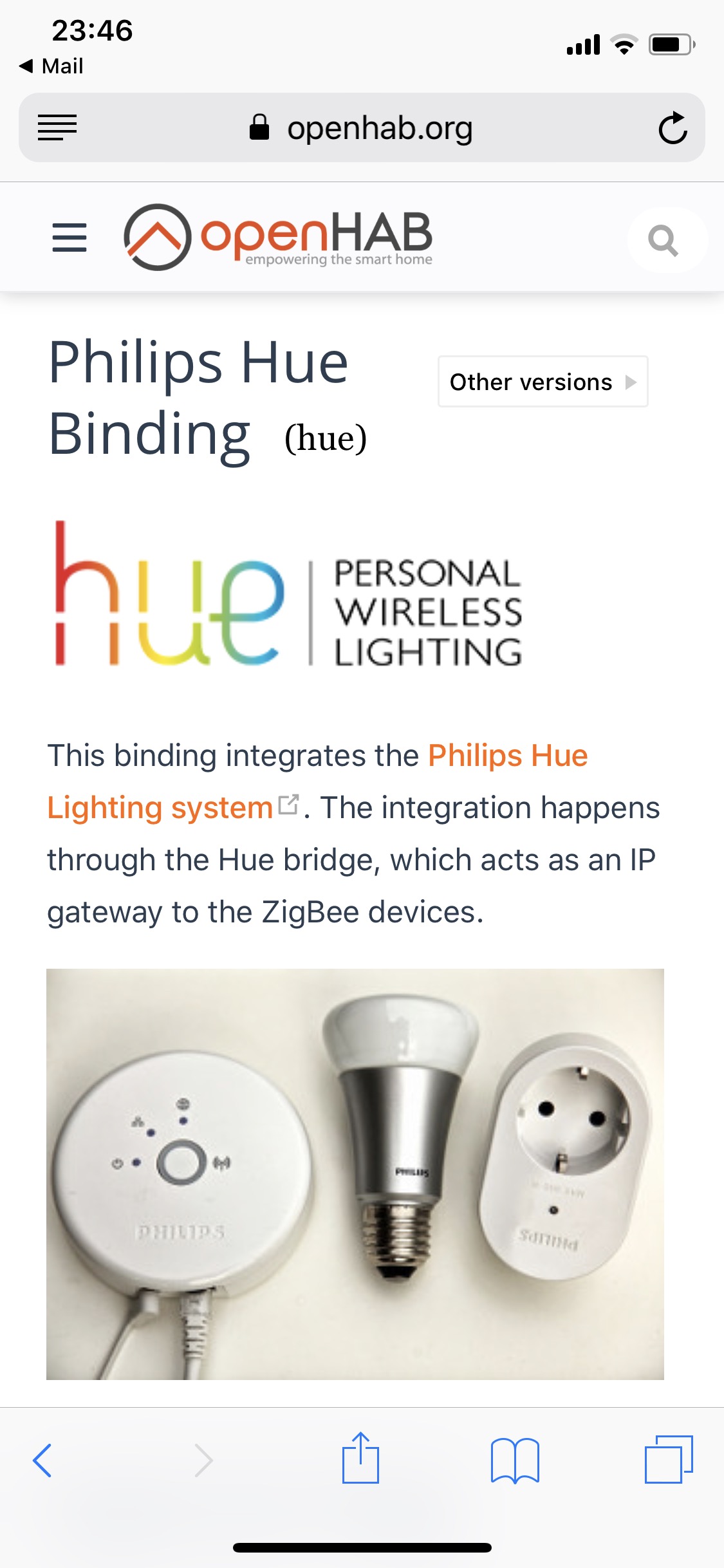

This is not shown on mobile devices (at least iPhones). We should evaluate if it is possible to add the name (perhaps in brackets) after the binding name in the documentation.
So you are telling me that there is no way to see the URL of the web page you are looking at on an iPhone? I’m skeptical but perhaps that is just another reason I don’t like iPhones.
No, you can of course view the full URL. I‘ve attached a screenshot (and edited it to show what i would find useful).
I won‘t argue pro/contra iPhone. But I like - and see it as additional security - that only the host part of the URL is visible. It‘s much clearer than the full URL. You can get to see the full URL if you tap on the hostname.
