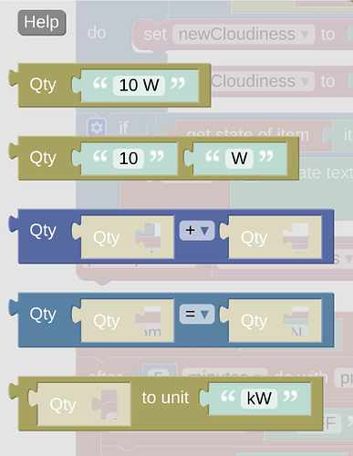

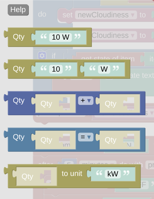

Or, for the best solution, stay working within units by using the blocks in the Units of Measurement category.

But of course it would also be possible (and somehow more correct) to calculate the ratio as max_24h W/m2 / 180 W/m2; I would get the ratio as a number without units.Unfortunately, that doesn’t seem to work. Maybe this max_24h is not handled as a number with unit blockly, only during run time?
Ah, no, my fault: I had to replace my comparison “/” by the Qty-version as well. Now its’ working as expected. Thank you again.
