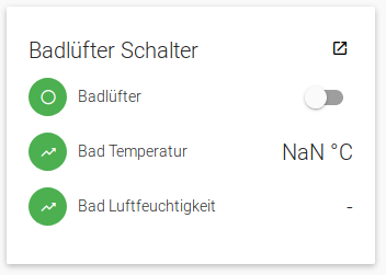

But it won’t display the value in my HabPanel:
grafik
What did i wrong?

Yes, but Maximilian has Things defined as Numbers. From sensor is JSON string so in Paper UI You see NaN because it is string not number

JSON path transformation was not installed. Now it is. But it doesn’t change anything.
This is my log before installing the JSON path transformation binding:
2019-12-05 17:34:35.507 [WARN ] [t.generic.ChannelStateTransformation] - Transformation service JSONPATH for pattern $.BME280.Humidity not found!
2019-12-05 17:34:35.509 [WARN ] [ab.binding.mqtt.generic.ChannelState] - Incoming payload ‘{“Time”:“2019-12-05T17:34:35”,“BME280”:{“Temperature”:19.8,“Humidity”:44.8,“Pressure”:954.8,“SeaPressure”:1023.7},“PressureUnit”:“hPa”,“TempUnit”:“C”}’ not supported by type ‘NumberValue’
2019-12-05 17:34:35.511 [WARN ] [ab.binding.mqtt.generic.ChannelState] - Incoming payload ‘{“Time”:“2019-12-05T17:34:35”,“BME280”:{“Temperature”:19.8,“Humidity”:44.8,“Pressure”:954.8,“SeaPressure”:1023.7},“PressureUnit”:“hPa”,“TempUnit”:“C”}’ not supported by type ‘NumberValue’
2019-12-05 17:34:35.511 [WARN ] [t.generic.ChannelStateTransformation] - Transformation service JSONPATH for pattern $.BME280.Temperature not found!
2019-12-05 17:34:35.513 [WARN ] [t.generic.ChannelStateTransformation] - Transformation service JSONPATH for pattern $.BME280.Temperature not found!
2019-12-05 17:34:35.513 [WARN ] [ab.binding.mqtt.generic.ChannelState] - Incoming payload ‘{“Time”:“2019-12-05T17:34:35”,“BME280”:{“Temperature”:19.8,“Humidity”:44.8,“Pressure”:954.8,“SeaPressure”:1023.7},“PressureUnit”:“hPa”,“TempUnit”:“C”}’ not supported by type ‘NumberValue’
2019-12-05 17:34:35.515 [WARN ] [ab.binding.mqtt.generic.ChannelState] - Incoming payload ‘{“Time”:“2019-12-05T17:34:35”,“BME280”:{“Temperature”:19.8,“Humidity”:44.8,“Pressure”:954.8,“SeaPressure”:1023.7},“PressureUnit”:“hPa”,“TempUnit”:“C”}’ not supported by type ‘NumberValue’
Ok, thank you all!
Now it is working. Rebooting helped OH2 to make it working. Now the temperature is displayed.
