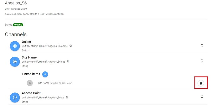

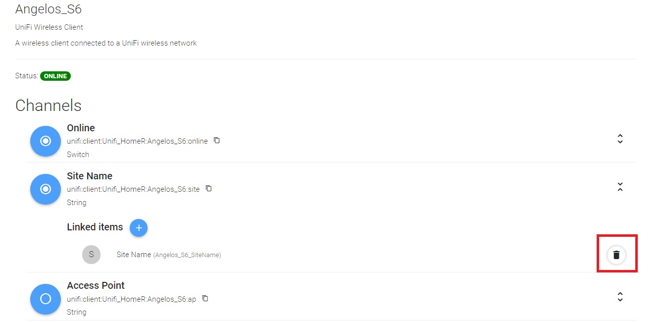

To clear out the contents from ItemChannelLink.json you should break the link from PaperUI.
