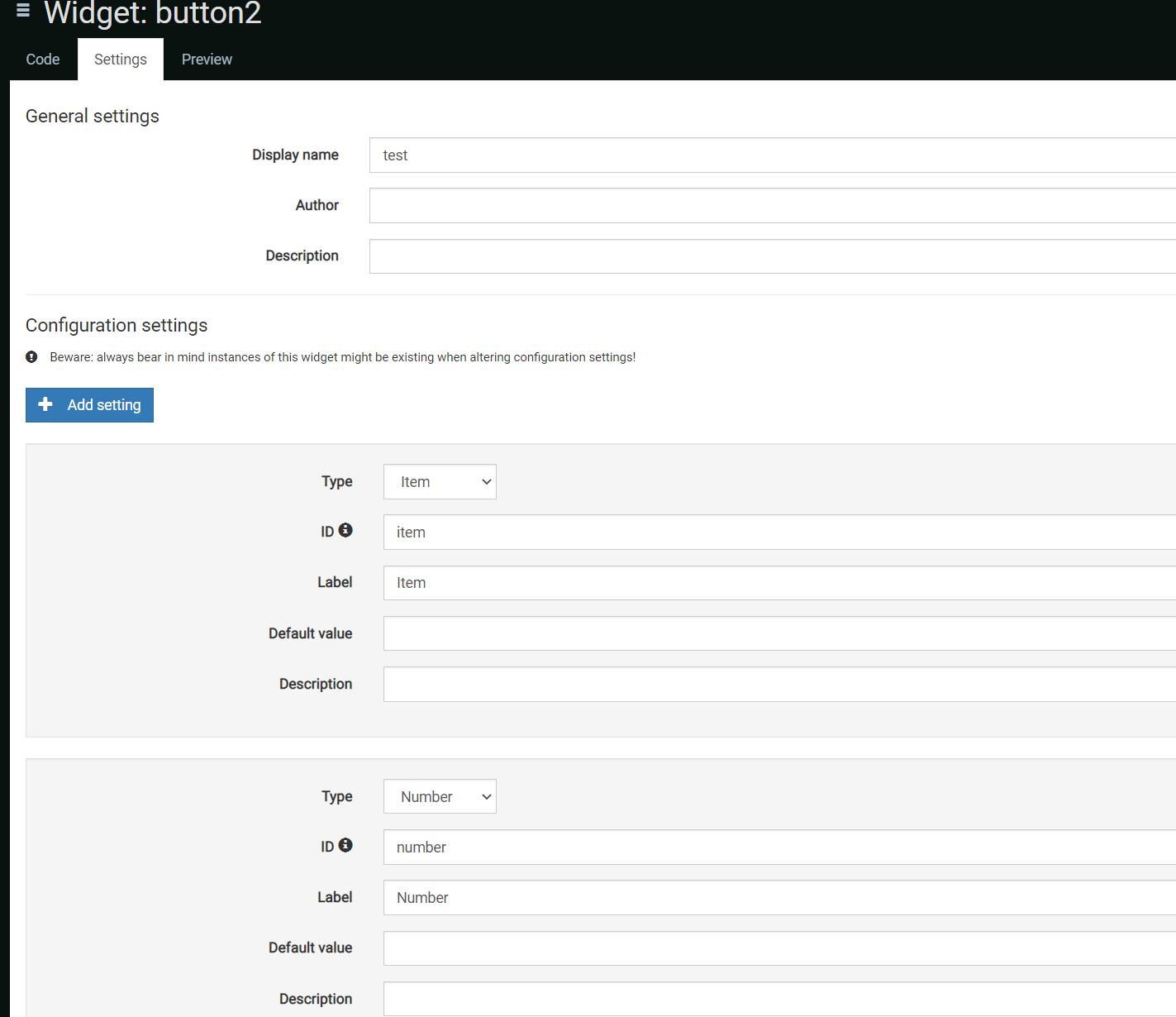

Widget settings:
My intention is to compare not the fixed value but the one defined in the widget settings:
This dos not work anymore:
ng-if="itemValue(config.item) == '{{config.number}}'"
This does not work as well :frowning:
ng-if="itemValue(config.item) == '{{itemValue(config.number)}}'"
I tried to change the variable form number to a string in the widget settings I can not simply get it working. I tried to comere with ’ ’ and without.
this one works:
 ng-if="(itemValue(config.item) != (config.number))"
