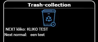

My items are created as follow:
String KlikoItem1	"Next event [%s]"	<calendar>	{ caldavPersonal="calendar:kliko type:EVENT eventNr:1 value:NAME" }
String KlikoItem2	"Next event [%s]"	<calendar>	{ caldavPersonal="calendar:kliko type:EVENT eventNr:2 value:NAME" }
String KlikoItem3	"Next event [%s]"	<calendar>	{ caldavPersonal="calendar:kliko type:EVENT eventNr:3 value:NAME" }
String OfficeCalName0	"Current [%s]"		<calendar>	{ caldavPersonal="calendar:test type:ACTIVE eventNr:1 value:NAME" }
DateTime OfficeCalTime0	"Start [%1$tT, %1$td.%1$tm.%1$tY]"			<calendar>	{ caldavPersonal="calendar:test type:ACTIVE eventNr:1 value:START" }
String OfficeCalName1	"Next event [%s]"	<calendar>	{ caldavPersonal="calendar:test type:UPCOMING eventNr:1 value:NAME" }
DateTime OfficeCalTime1	"Start [%1$tT, %1$td.%1$tm.%1$tY]"			<calendar>	{ caldavPersonal="calendar:test type:UPCOMING eventNr:1 value:START" }
String OfficeCalName2	"2nd next event [%s]" <calendar> { caldavPersonal="calendar:test type:UPCOMING eventNr:2 value:NAME" }
DateTime OfficeCalTime2	"Start [%1$tT, %1$td.%1$tm.%1$tY]" 			<calendar> { caldavPersonal="calendar:test type:UPCOMING eventNr:2 value:START" }
So, it seems to do something, but not what I expect..

It seems to be working…the logfiles show events now!!
and my items are getting filled with info!
the first item “NEXT kliko” is from calendar1
the next item “Next normal” is from calendar2
So…it’s working!
