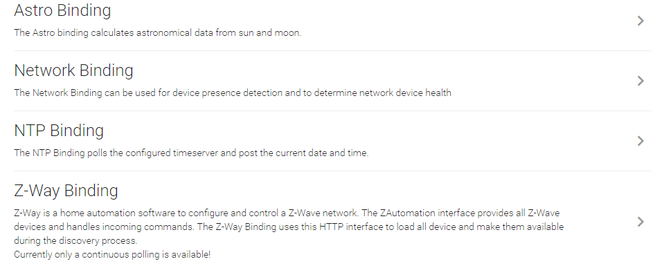

So here’s something new this morning: I removed the Z-way binding and re-installed, to show the log entry. The entry "Uninstalled ‘openhab-binding-zway’ " shows, but there is no log entry when I re-install it. But I can see it in Paper UI when I select the Inbox:
Maybe you mixed it up? You have to install the z-wave binding. But in your screenshot there is shown the z-way binding.

I didn’t even realize the different, and hadn’t heard of z-way before. After installing the correct binding I had the controller link right up.
