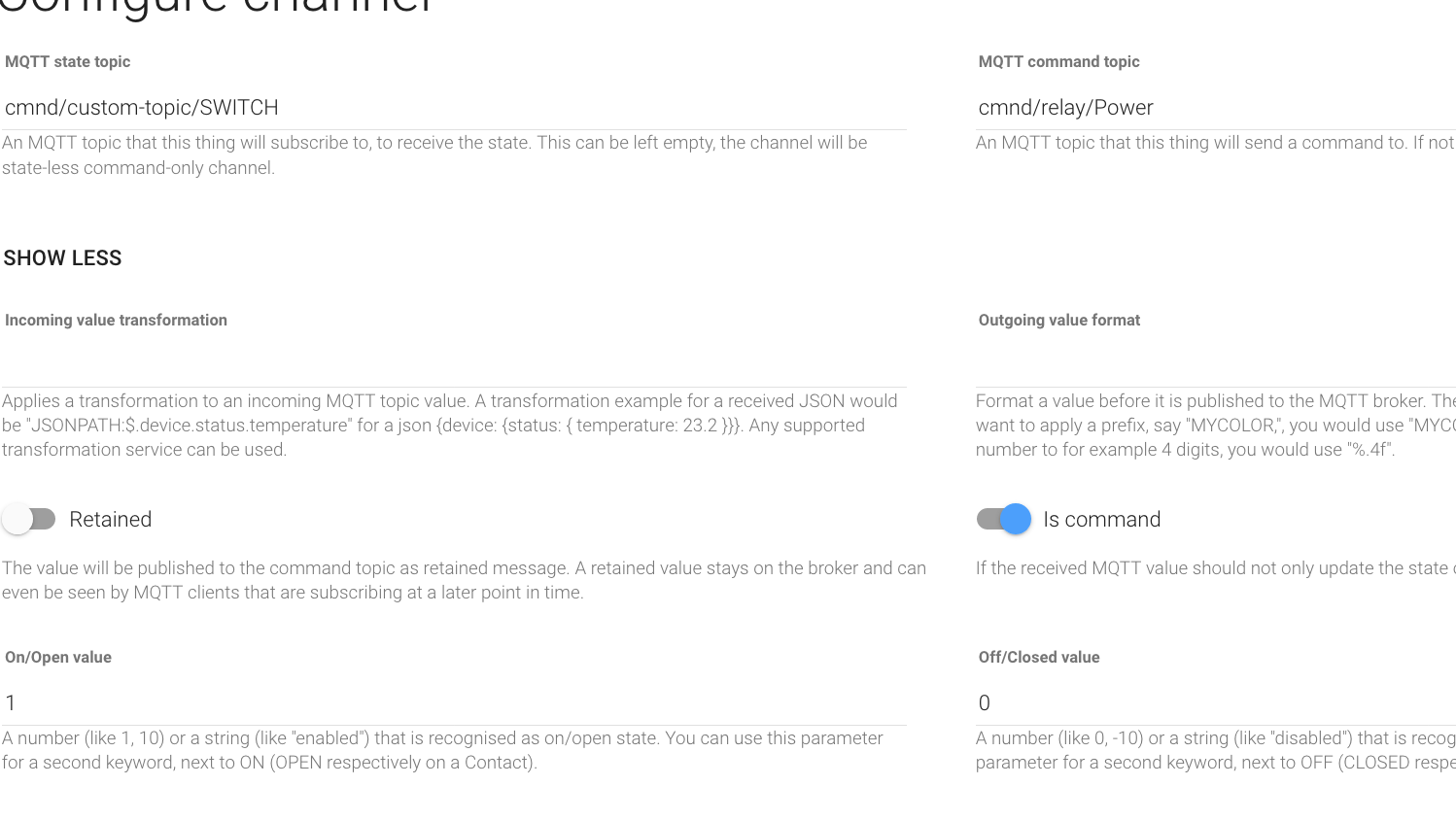

Switch (controlling) Tasmotas is configured as Generic MQTT Thing. Is has On/Off Switch type channel with state topic and command topic. State topic is cmnd/custom-topic/SWITCH . Command topic is cmnd/relay/Power, with Is command enabled.
Problem is, the command is never published. The state topic is monitored OK, I can see the widget changes accordingly. The relay itself works: I can trigger it from mqtt client. I even created an auxiliary “switch” channel with command topic only for cmnd/relay/Power and I can use it to trigger relay manually. But for the main switch channel, I cannot make the incoming mqtt message to trigger the outbound command.

3 Since it’s configured in UI, here’s the screenshot:
4 I used Simple mode, items are created& linked automatically for each channel, so yes.

Well its a bit confusing. I thought it looks like this:
But you say its an openHAB command. You are not talking about mqtt message, right?
Quite right - I was talking rubbish, and got confused with postCommand.:crazy_face:
postCommand takes an MQTT message and turns it into an openHAB command.
commandTopic takes an openHAB command and turns it into an MQTT message.

Will not happen. When an MQTT message arrives at openHAB, the stateTopic willpost it to a channel and onwards to an Item.
If an openHAB command arrives at an Item, a channel will pass it a binding, and in this case the MQTT binding will use the commandTopic to create an outbound MQTT message.
Note that there is no link between inbound state and outbound command. That’s quite deliberate, state and command kept separate else practically everything would end up in an action/response/action loop.
You need to do something else to create that link.
One way is rules - listen for a state update, issue a command.
Another way is follow profile - configure a channel to convert incoming state to a command on an Item. Binding can then process command in the usual way. This needs an Item with two channels.
Another way is to use postCommand to cause the binding to massage incoming MQTT into an openHAB command, which the MQTT binding can once again use for an outgoing message. This needs to be done via an Item with two channels.
An extra complication is that Contact type Items in openHAB do not handle commands, so probably not suitable for the way you are working here.`
